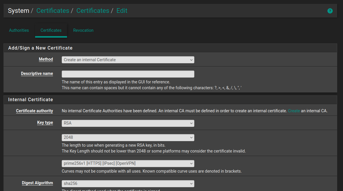

      Yet, I'm unable to use them to create a new certificate. It just says "No internal Certificate Authorities have been defined. An internal CA must be defined in order to create an internal certificate. Create an internal CA." :
      If anyone has any ideas on how to solve this, it would be much appreciated.

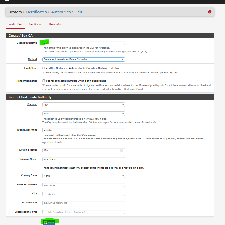

              Double Doh...
              I'm using 25.07.1 as well (on a 4100) and I can create a CA by entering 'test' and hit the save button :

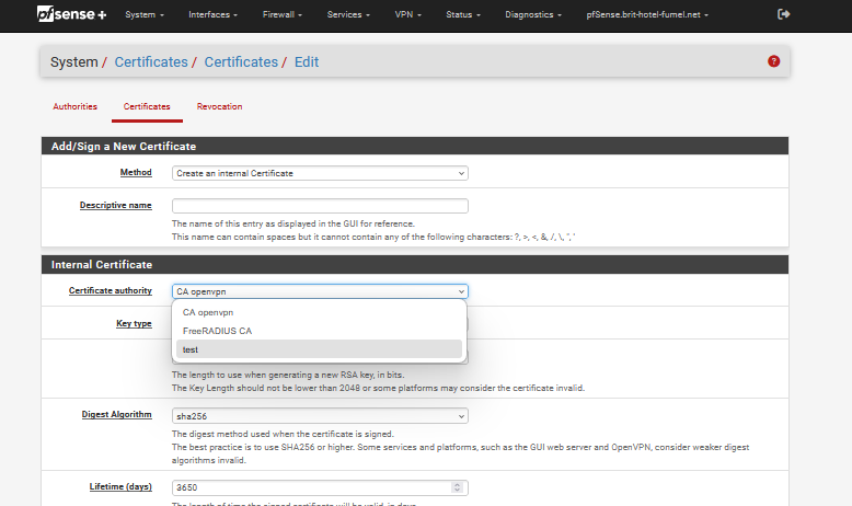

              When creating a certificat, I can select/use it :
              so not sure about what is going on.

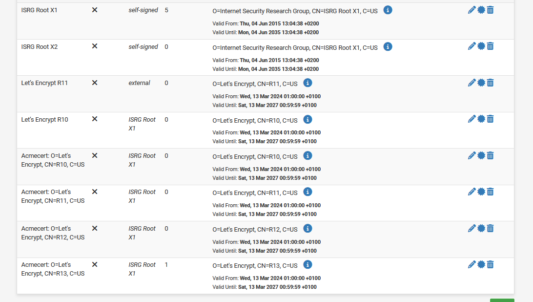

                    Delete all your CA. (edit : the ones you've added yourself. There may be other certs - see the image below, you've probably imported these don't delete these)
                    Then, as I've shown above : create a new CA. Name it like me : "test" do/add nothing else, and hit the Save button.
                    Now, create a certificat, and check if you can select the CA named "test".
