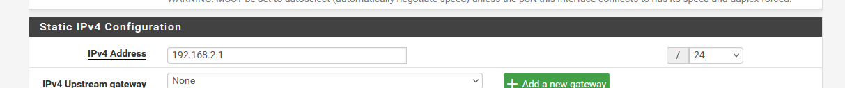

        When you created OPT1, you had to assign it a static IP, like this :
        Why 192.168.2.1 ?
        Because 192.168.1.1/24 is already used by the LAN interface.
        Double check that you've set the 'network' to /24 - leaving it to /32 will .... create the situation you have now - so /32 is not good.
        If you've set up this 192.168.2.1/24 network, you also have to activate a DHCP server for the OPT1/192.168.2.1/24 network, with a pool (of IPs) like 192.168.2.10->192.168.2.50.
