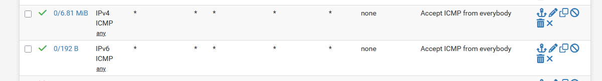

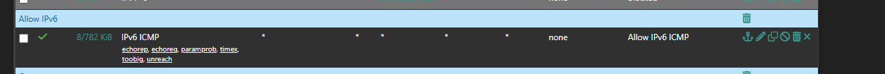

      I have this rule set up (I can't remember where I read it or the context as its been years since I added it in!) and I need it validated here.
      In my WAN and other VLANS I have this firewall rule set up (see screenshot):
      IPv6 ICMP (echorep, echoreq, paramprob, timex, toobig, unreach) allow all
      Is is really required for WAN and all VLANs?

        I've the same rule btw on my WAN (!) :
