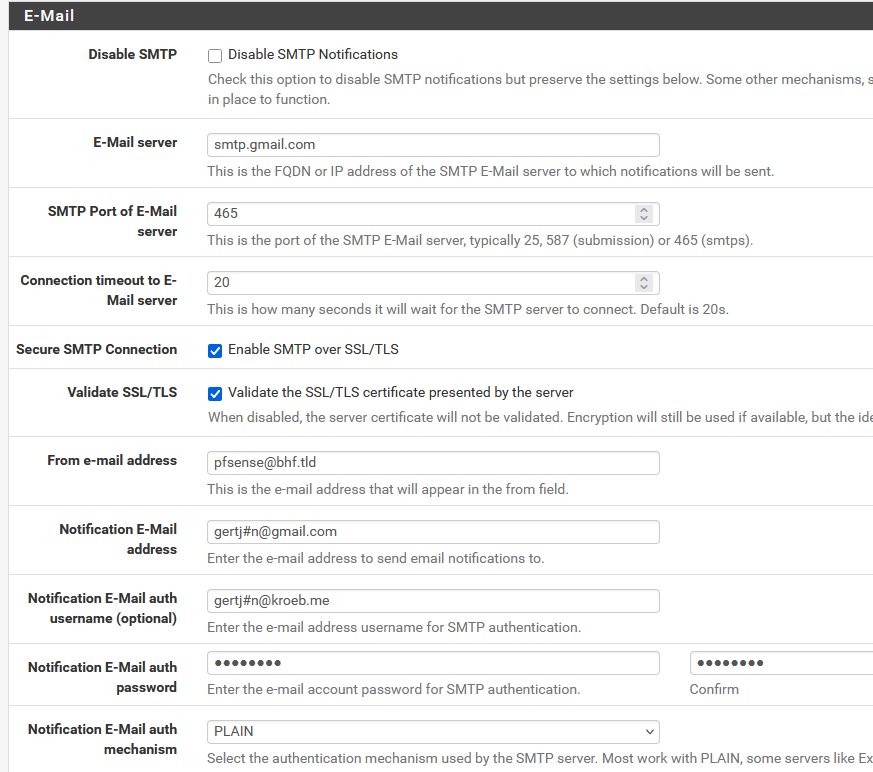

              If you don't have issues with the usage of a gmail, this is easy to set up, you'll get a real time notification on your phone for free :
              as the traffic is TLS "from bit zero" (port 465 = pure TLS) you don't need to tunnel it, it's already encrypted.
