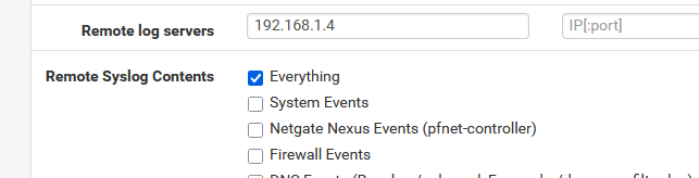

            You've selected "Everything" :

              everything is selected.
              the last line is . @Syslog_server_ip_address:port (with the ip).
