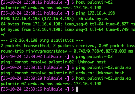

      My network uses 172.16.xxx.xxx/22, so it uses 172.16.4.0 through 172.16.7.255 for address space. added a new device today, at 172.16.4.198, configured to use palantir-02. (On this LAN, the FQDN would be palantir-02.arda.ea.) My desktop, a Mac, is at 172.16.7.7. The subnet mask on the Mac (which it gets from pfSense's DHCP, right?) is 255.255.252.0. (I've checked that with a mask calculator to be sure.) For instance, I can ping a device at 172.16.5.50. But when I try to deal with this new device at 172.16.4.198, I get this:
      So I can get the IP address, I can ping the IP address, but I cannot ping by the registered name, using just the name or the FQDN. (I have my Mac configured to add ".arda.ea" to a name if it isn't a FQDN.) I also cannot reach it with Chrome on my Mac.
      I can ping it using LibTerm on my iPhone, using ping palantir-02.arda.ea without issue.
      What's going on with this and how do I fix it?
      Addendum: I also tried this device at 172.16.7.198 - putting it in the same 24 bit mask as my Mac and got the same results. I do have devices detecting it, so it's "live," but unreachable on my Mac.

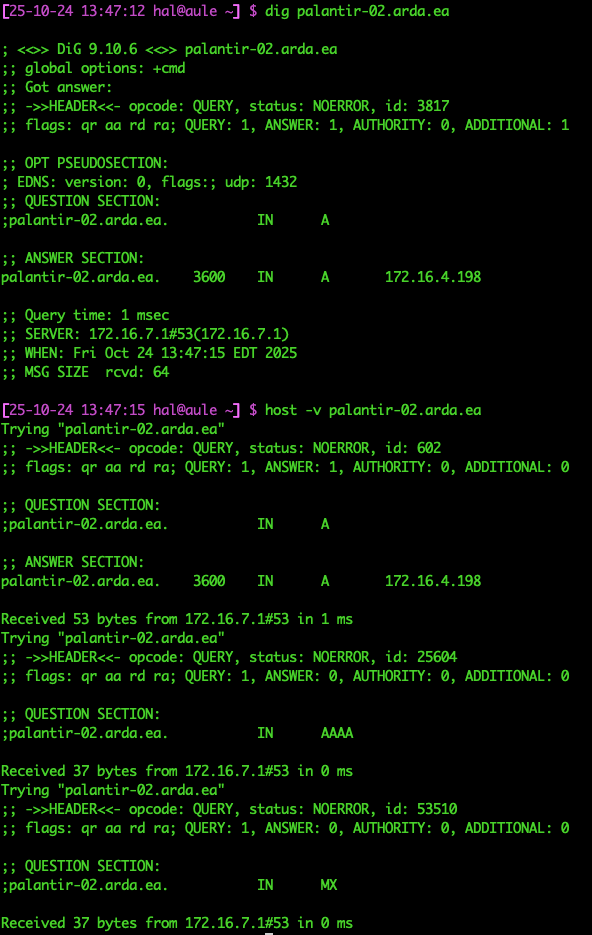

        @TangoOversway said in Can get host address, can't ping device:
        if you can ping it via fqdn using your phone.. Why would you think this is a pfsense issue? And not whatever device you are having issue with problem?
        Is your phone using different dns than whatever other machine your trying to resolve from.
        Do a simple dig to palantir-02.arda.ea - so we can see what your actually doing a query for, and that you actually get back as response, be it nx, etc.. Or use host -v palantir-02.arda.ea
        This would give you some output with actual details.

          Did two of the commands you talked about:
          I'm not clear - the last command, host -v -t A nas.home.arpa is way out of my understanding. I just get that nas.home.arpa is not found.

            @TangoOversway so clearly dns server at 172.16.7.1 is answering.. Why your machine can not resolve it via ping is on the machine.
            As to -v and -t A, -v is verbose out - ie you can see exactly was ask for, and who answered it, etc. The -t A is saying only ask for the A record.. Notice in your host -v its also asking for AAAA and MX records. which you have none.
            Where do you see that nas.home.arpa was not found - its IP is 192.168.9.10, which was returned for the A record, it has no AAAA or MX record, etc.

            If I was having the issue, I would sniff on your machine (packet capture) and when I ping for the fqdn of something that should resolve - see what it is actually doing.. Maybe it is only doing a mdns query, or a lanman type broadcast. Which yeah isn't going to work most likely, unless the thing your trying to find actually answers and is on the same network... Which from its ip 172.16.4 I would assume is a different network? If you client your trying to ping from is on the same network as the 7.1 you are asking for dns.
