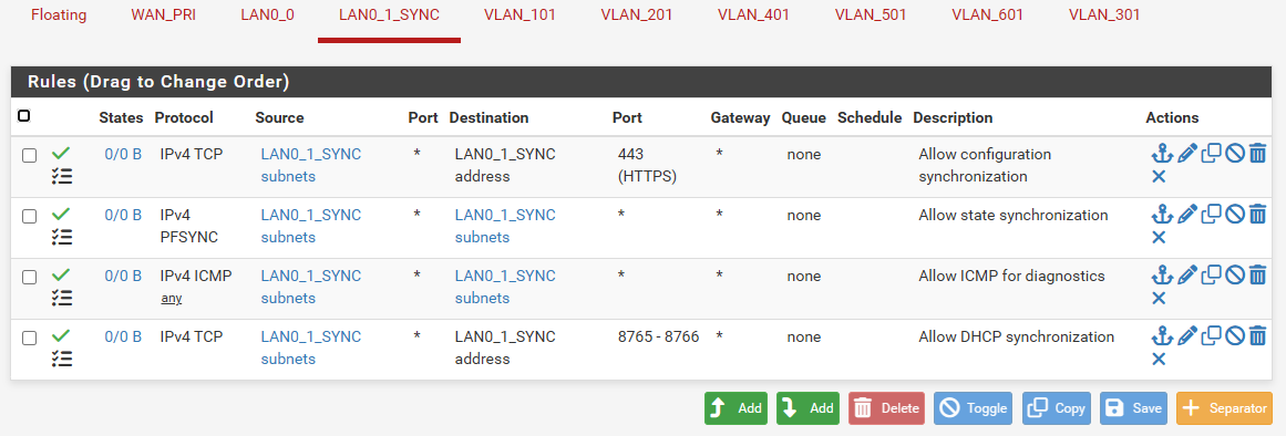

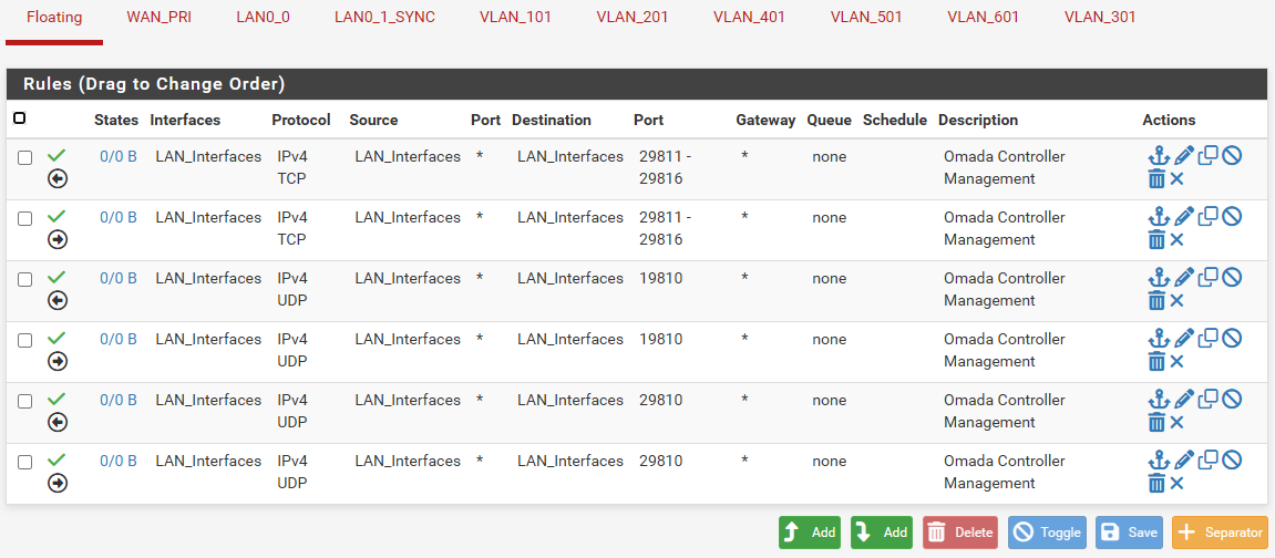

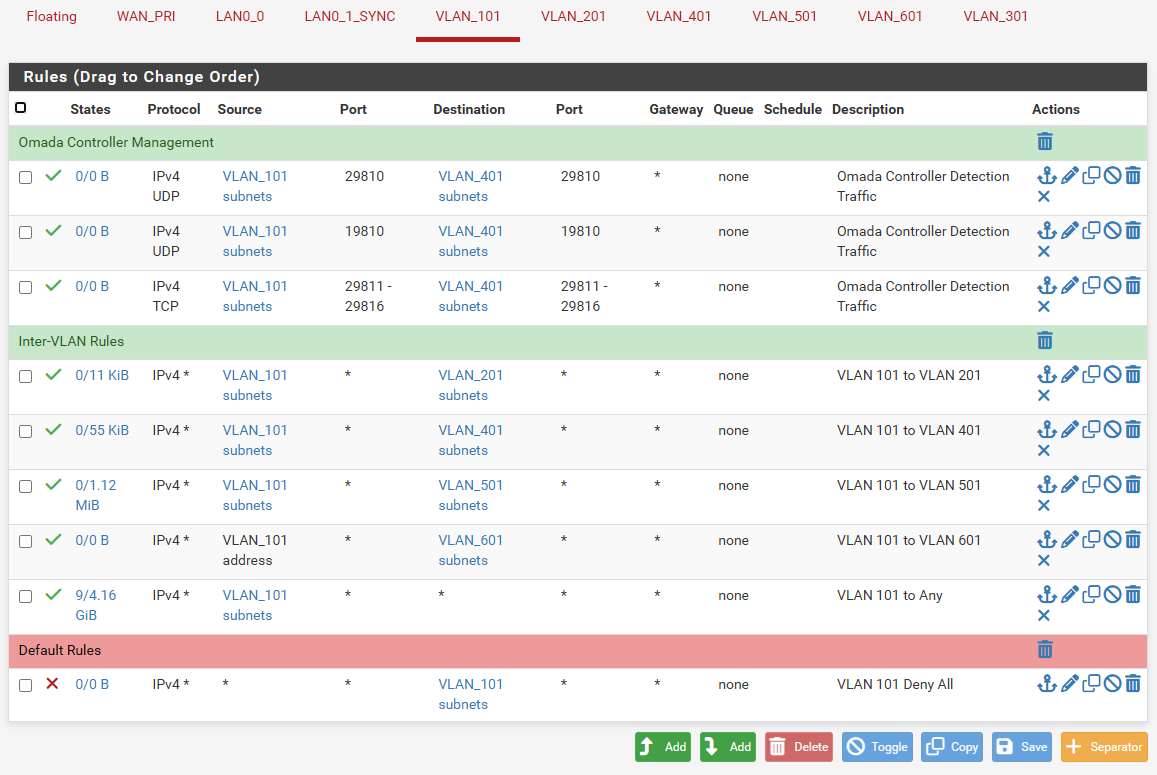

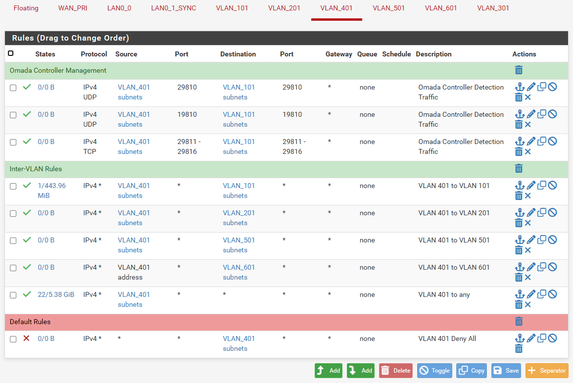

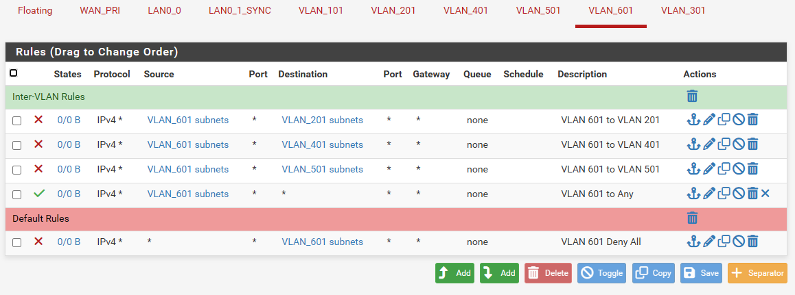

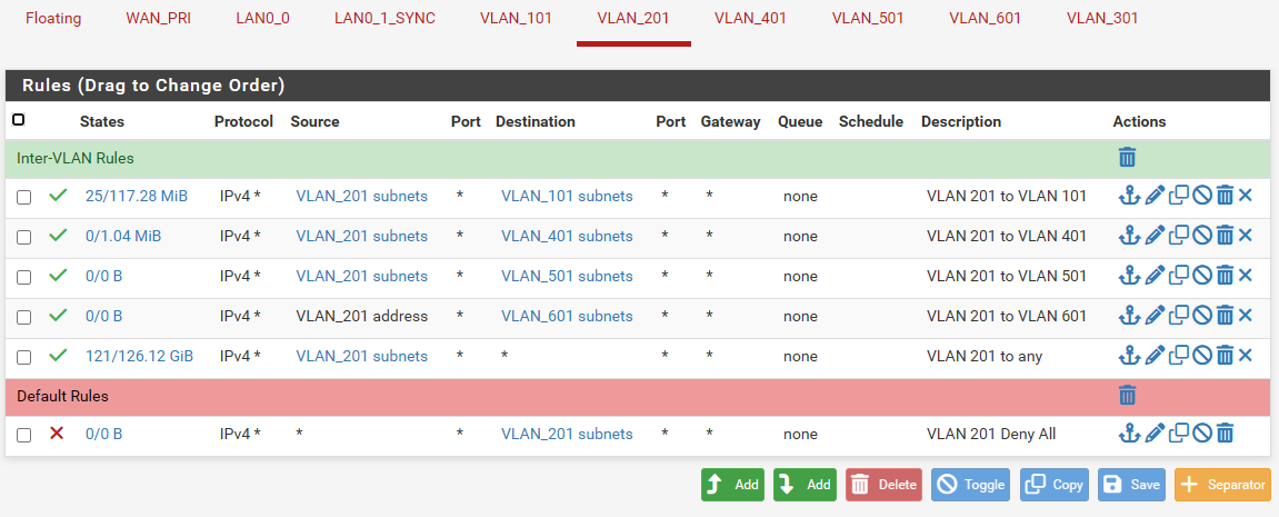

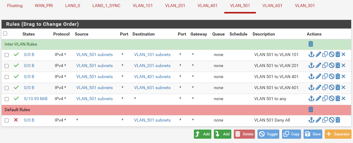

          @stephenw10, no, I'm not able to access the webui from any VLAN on igb5 even though the rules and everything else are the same with the firewall already working with the VLANs on igb0. I have attached the rule set from the firewall that works with the VLANs attached to igb0.
          floating rules.png sync rules.png vlan101 rules.png vlan201 rules.png vlan401 rules.png vlan501 rules.png vlan601 rules.png

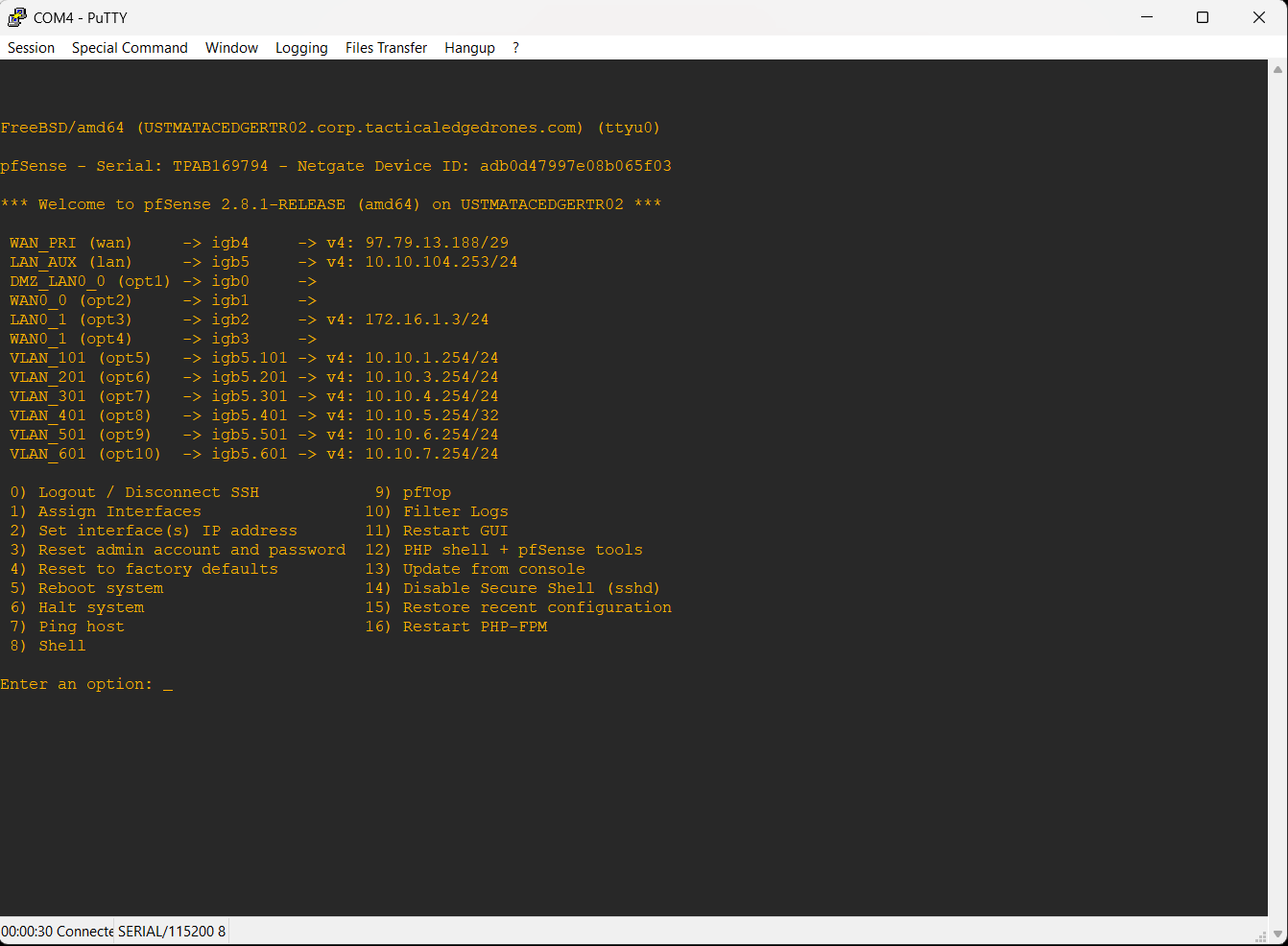

          Also, the following image shows you how the new firewall is configured:
          Let me know if you need any additional information.
