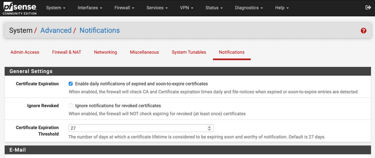

    Has anyone been able to get outlook or gmail notifications to work?
    7 Posts 4 Posters 252 Views 4 Watching
      amrogers3
      Seems like a common problem and I see a lot of posts where people are struggling to get this to work.
      I've been banging my head against the wall for a couple of days. Can't find any recent guides on this. Everything is several years old. I have tried app passwords and various settings to try and get this to work. Can't get it going.
      Anyone been successful in getting notifications to gmail or hotmail?
      Running pfSense 2.7.2
      A KOMK 2 Replies Last reply Reply Quote 0

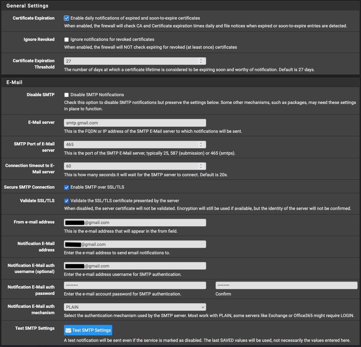

          I have notifications working with Gmail application passwords. It works every day without difficulty. My notifications config is:

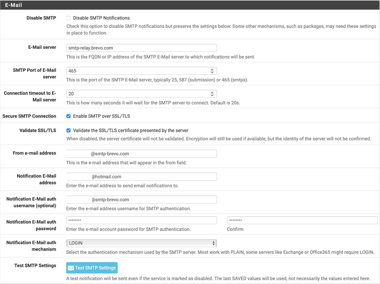

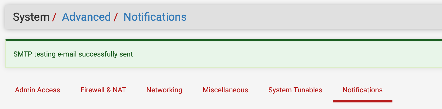

            I am trying to use Brevo and I finally get a successful send but maybe ISP is blocking. Maybe this is more trouble than it is worth :)
              Mission-Ghost @amrogers3
              @amrogers3 said in Has anyone been able to get outlook or gmail notifications to work?:
              Are you using an app password?
              I am using an app password successfully.
                Yup you have to use an app password with gmail since they tightened security a while back.
