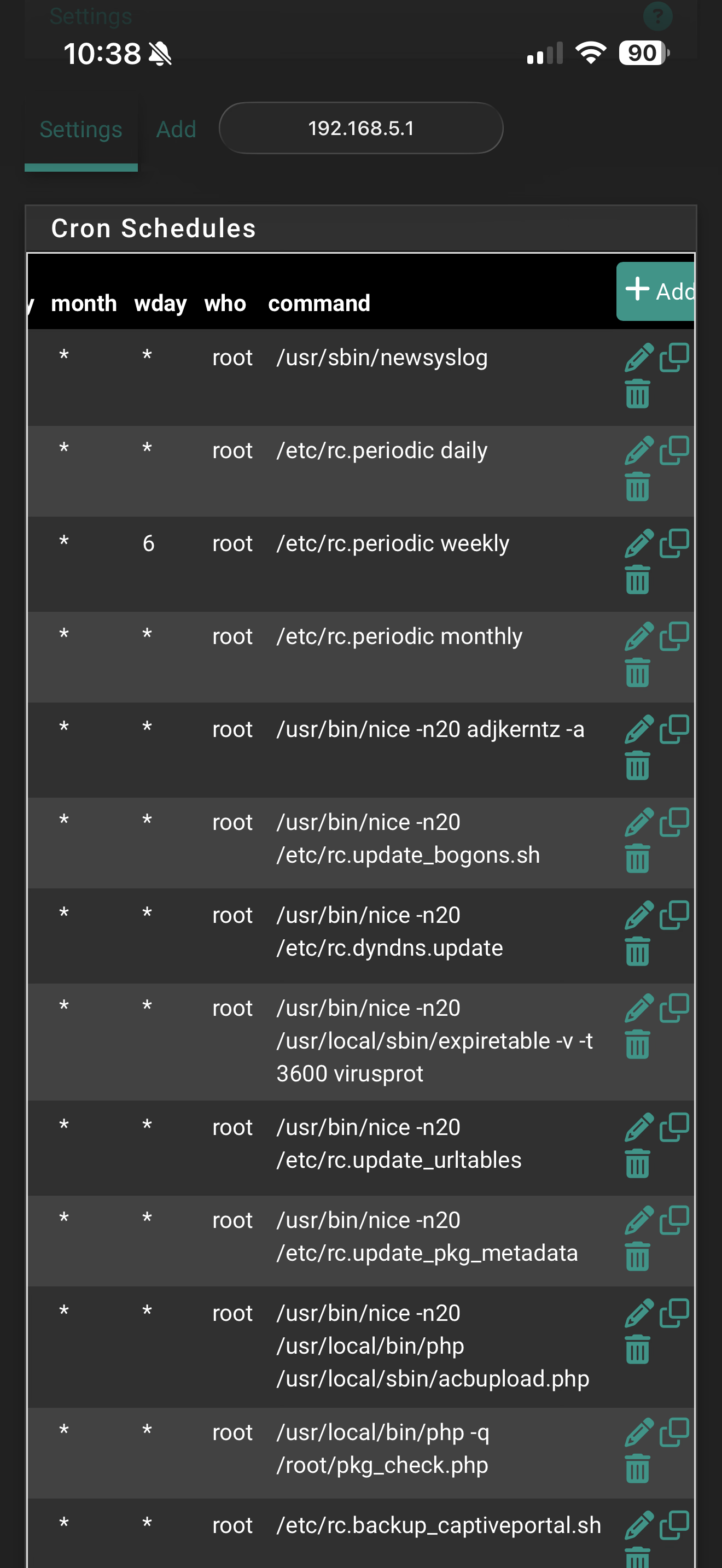

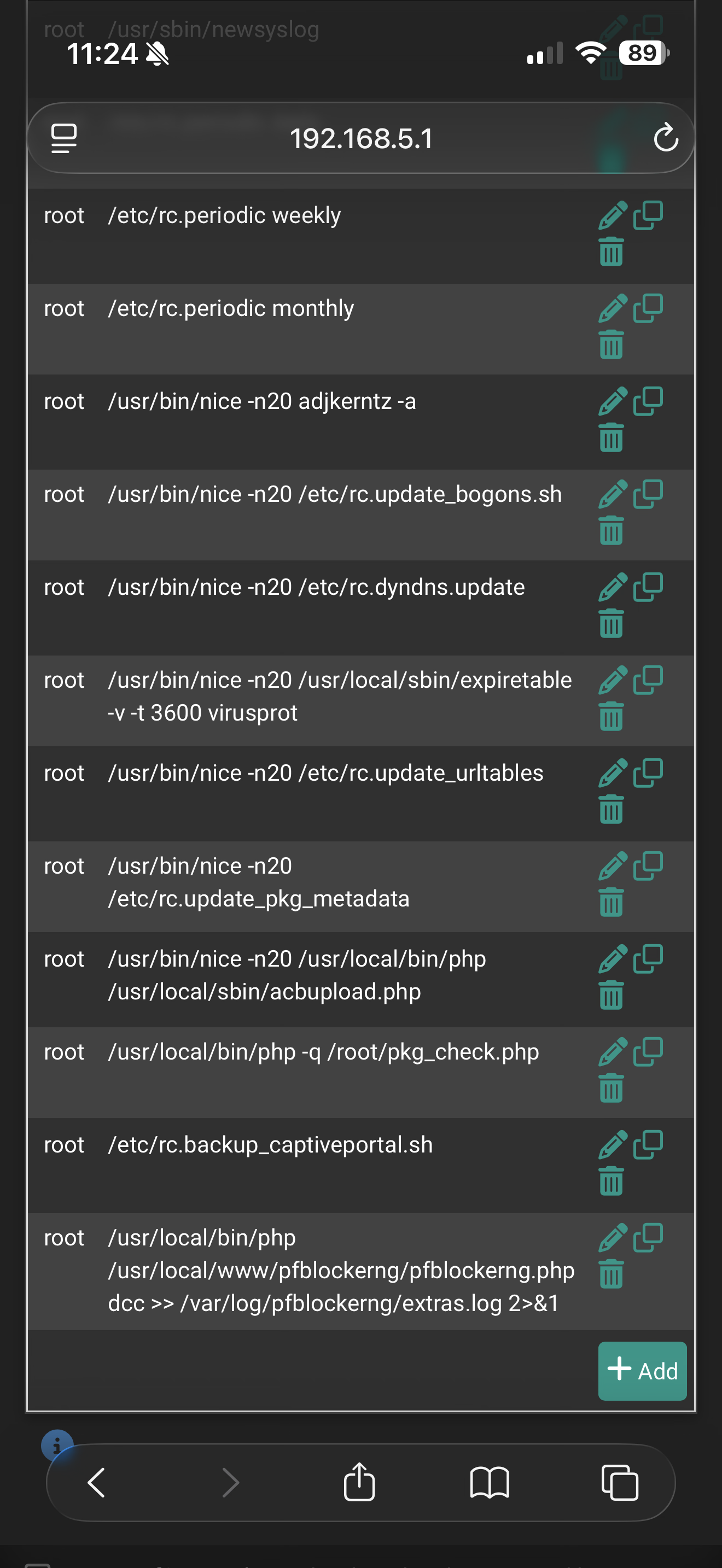

      Well, reloaded the previous backup that I had saved prior to update and now the Cron jobs have appeared again. Whew!
        Hmm, well the cronjobs are stored in the config so they would be restored that way. But pfBlocker should should have added it when it installed anyway.
        I can't replicate that here though.
          marcosm Netgate
          In my testing when the package is re/installed or enabled, the cron job is added. You can go through the system logs and configuration history to see at what point it was removed and if anything occurred afterwards that should have added it back.

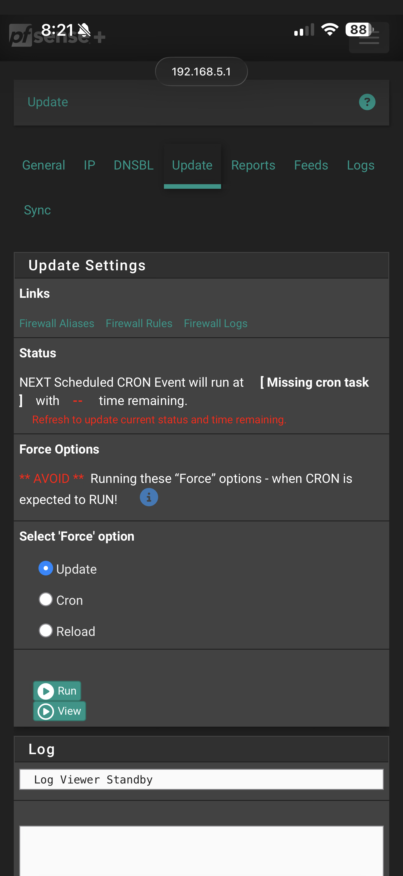

              Well, the Cron info disappeared from the update screen again but the Cron jobs are still showing there so I am not sure what is going on. I rebooted and had to leave the house so I am not sure if the they are back so will see. I am not home at this time to test again though.
                Just to be clear though you are running the dev package version?
                Can you test the regular package if so?

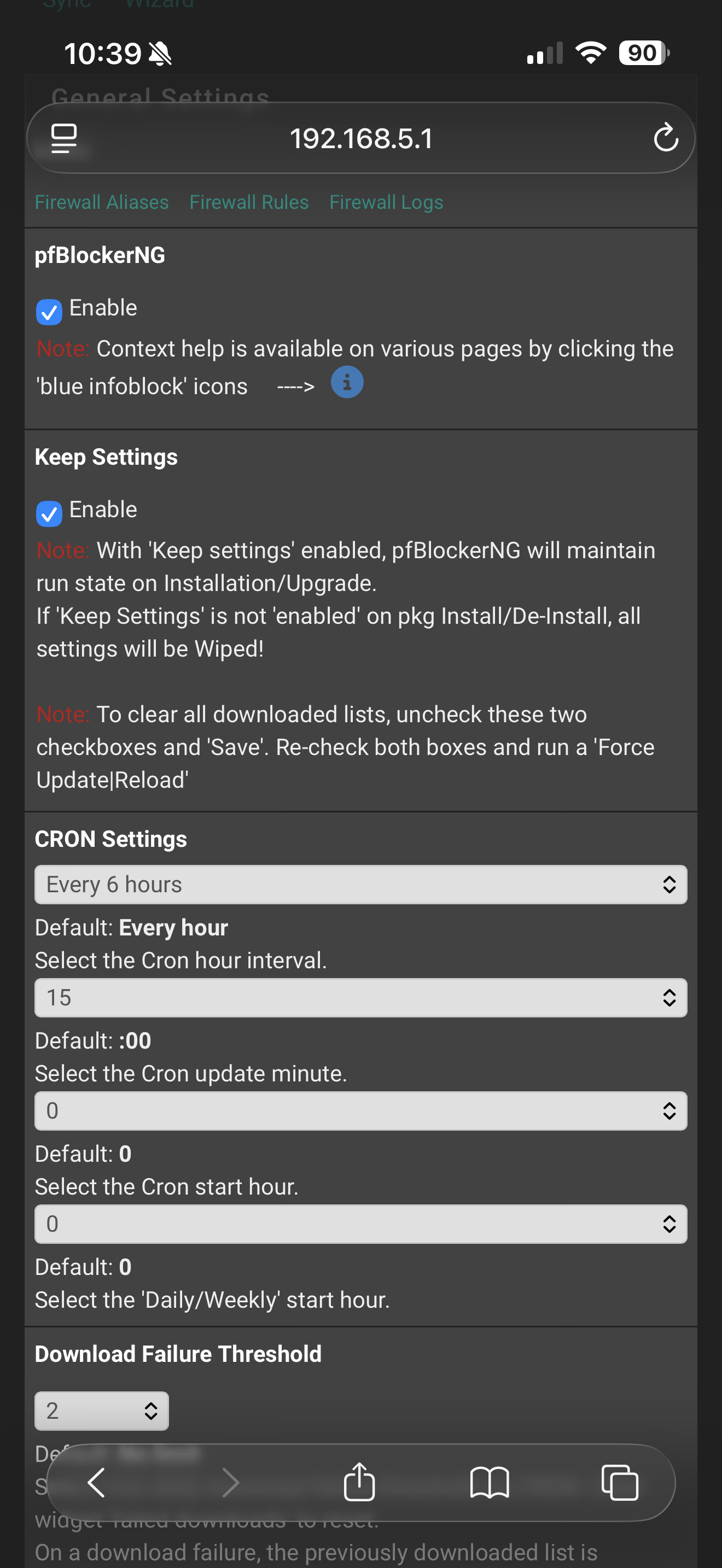

                      marcosm Netgate
                      I expect the non-devel version won't have the issue - there were recent changes related to the cron job creation in the devel version.
