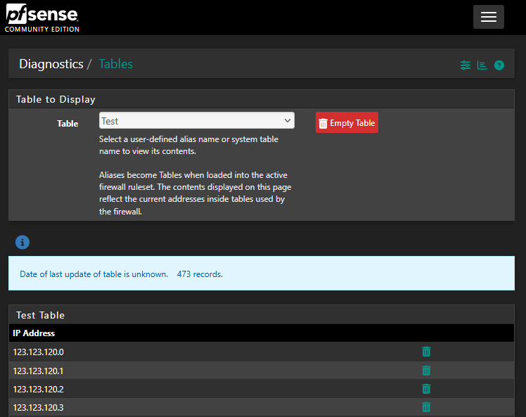

          Hmm OK I can replicate case 2 here. Digging....
          Do you see the full alias set shown in the Resolver logs when you add it?
          For me I see that and it does load all 512 entries after a delay.

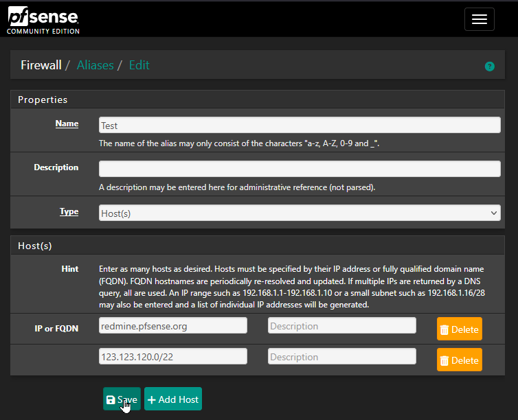

            I was testing last night and I think I have found the case which actually started my searching.
            • create an alias type network containing two /24 network and a couple of. /32 I have been using FQDN here which I think triggers alias table creation.
            • create an alias type host containing two expanded /24 network and a couple of single hosts
            • create an alias containing the above two alias.
            • I also created a firewall rule using the last alias but don’t think that’s essential
            • for test repeatability I have been clearing the alias tables, saving the configuration, then restoring the configuration
            For me alias table generation locks up completely at about 300 entries. I think it also blocks other alias calculations. Tested in v2.8.1 and v2.7.2

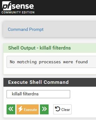

                  @Patch If you run "killall filterdns" and Status>Filter Reload do the tables populate?
                  Upvote 👍 helpful posts!

                        • P Offline
                          Patch @SteveITS
                          @SteveITS said in Unexpected alias behaviour - two ranges:
                          No but I guess this is not the expected response
                          btw @stephenw10 what happens when you try to replicate the behaviour?
