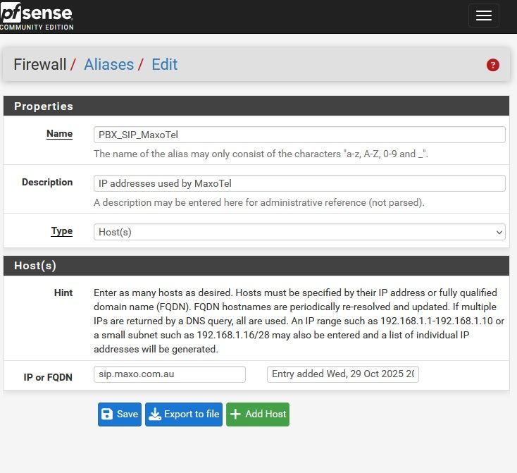

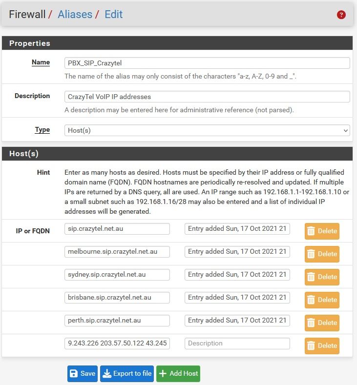

            Create base Alias

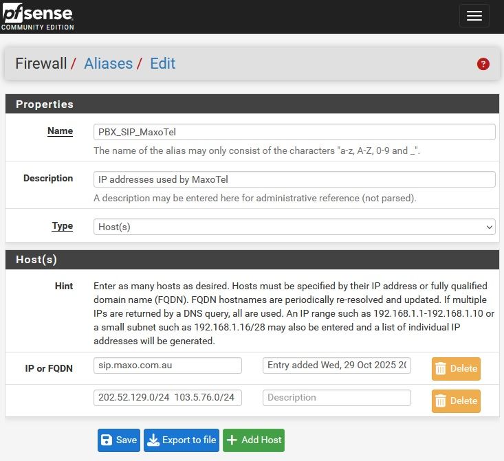

            Try to add two networks as single entry

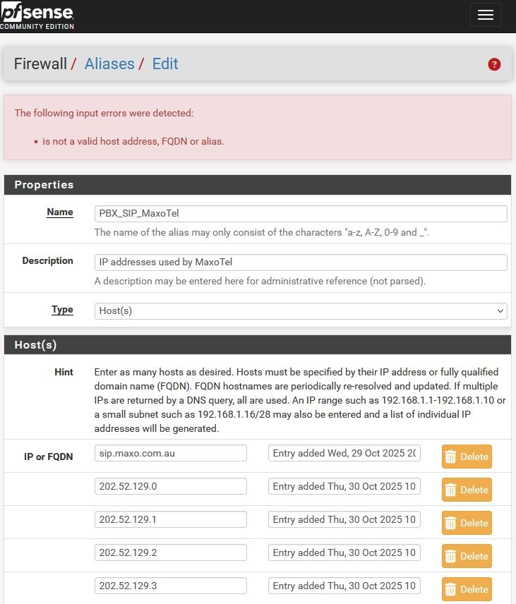

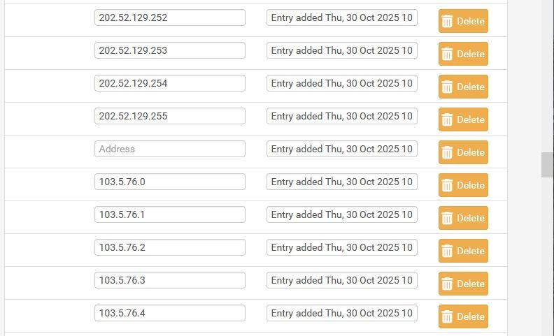

            Error reported with empty host visible on scrolling
            Deleting empty host (by clicking on it's delete button) then save alias appears to work but corrupts configuration. Rules which use the alias behave unpredictably.

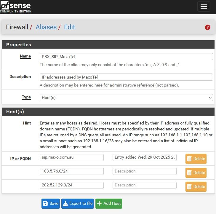

            Solution.
            Restore configuration from prior to above entry then enter networks on separate lines

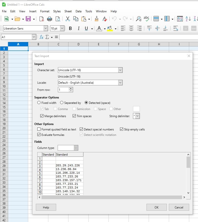

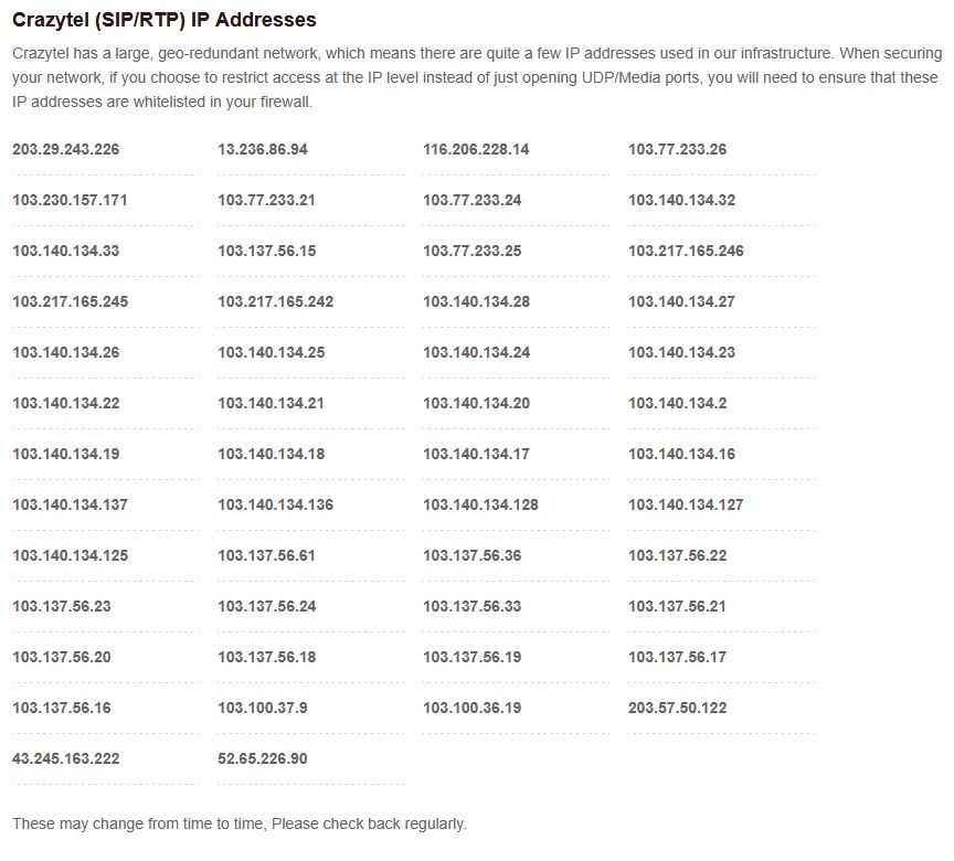

                      To illustrate,
                      For one of my VoIP suppliers, after logging into their web interface they show their IP addresses in the following format

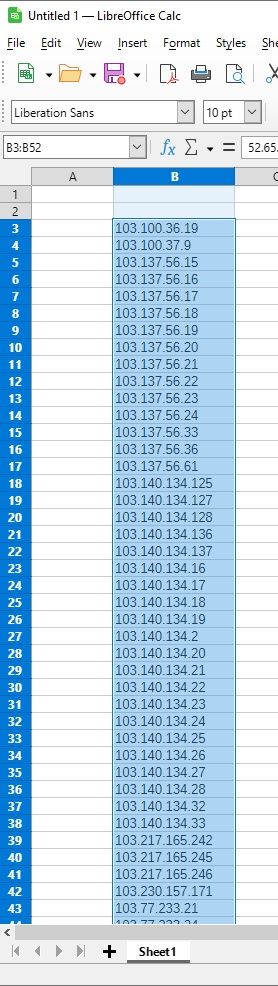

                      The IP address section can be selected then copied into LibreOffice - Calc
                      Which results in a list of IP addresses. Optionally sort then select and copy

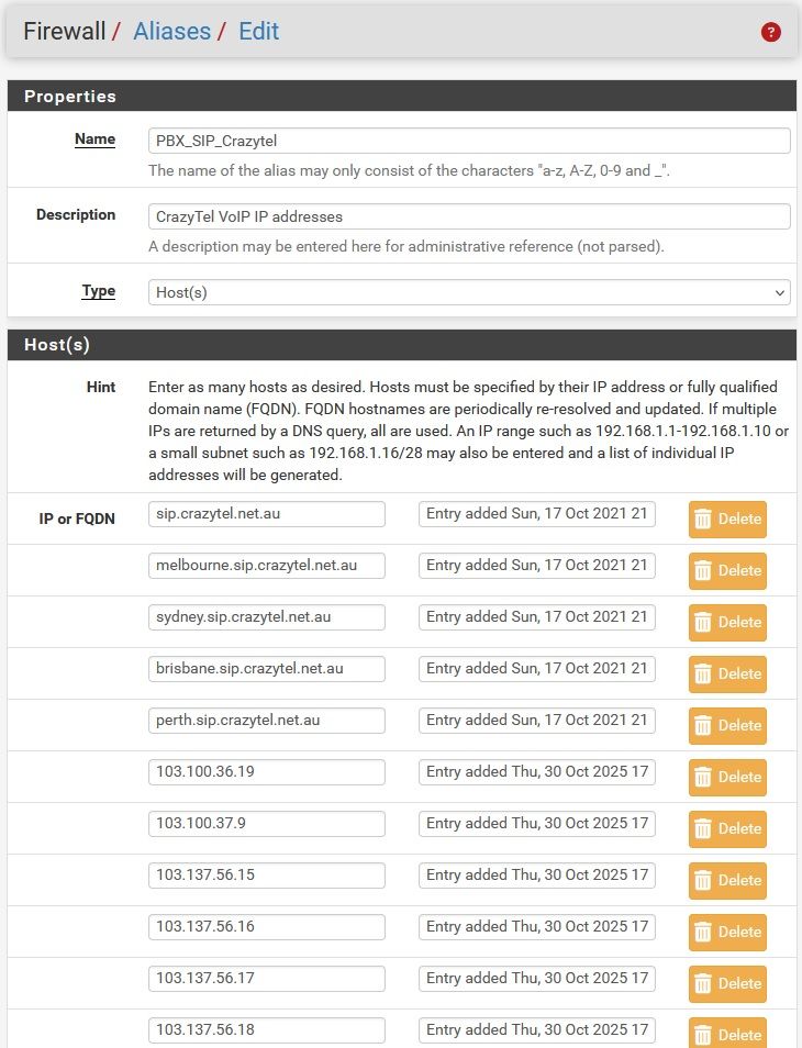

                      Click save and pfsense expands as shown by editing that alias again

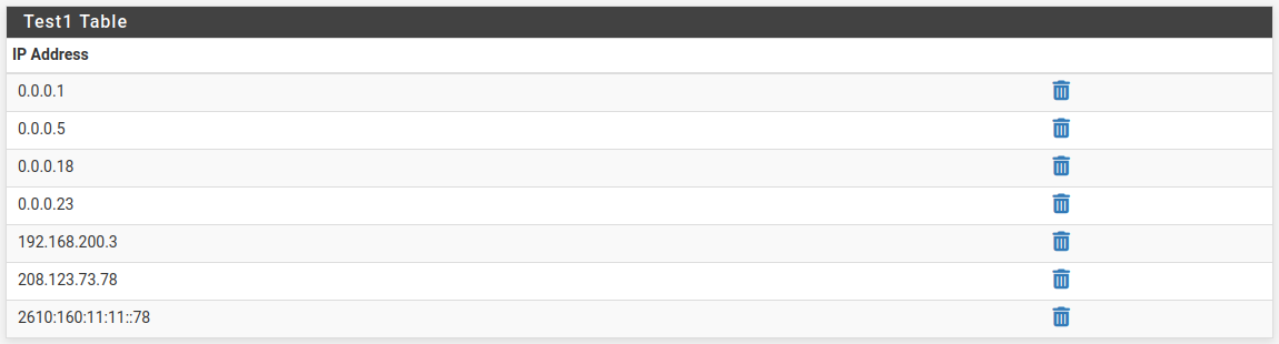

                                Hmm, I imagine it would try (and fail) to resolve those. Let me see here...
                                  Hmm, nope it interprets them as an IP address. Which is interesting. I expect that to fail the input validation but perhaps the fact it can be an fqdn allows it.
                                  Oct 30 14:37:58 	filterdns 	25069 	Adding Action: pf table: Test1 host: 1
                                  Oct 30 14:37:58 	filterdns 	25069 	Adding Action: pf table: Test1 host: 18
                                  Oct 30 14:37:58 	filterdns 	25069 	Adding Action: pf table: Test1 host: 5
                                  Oct 30 14:37:58 	filterdns 	25069 	Adding Action: pf table: Test1 host: 23
                                  Oct 30 14:37:58 	filterdns 	25069 	Adding Action: pf table: Test1 host: pfsense.org

                                          @stephenw10 said in Unexpected alias behaviour - two ranges:
                                          I suspect there was a rogue character in @Patch's imported list
                                          You are correct. The networks were separated by a double space. Sorry the forum removes double spaces so you could not copy from my post. Using a single space prevents creation of the blank host. But doing so does not fix the problem with creating the desired Alias.
