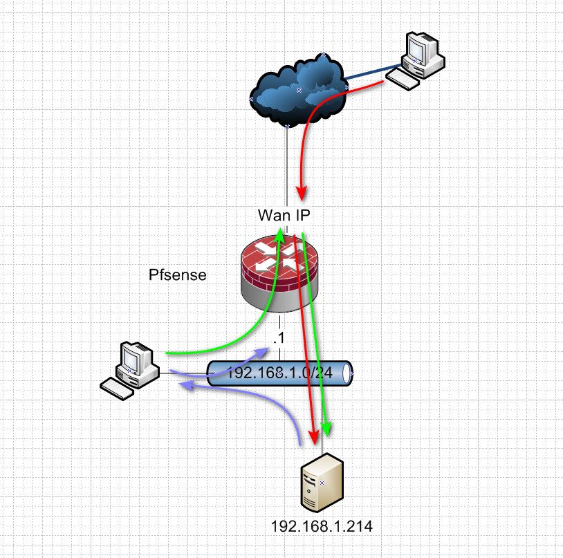

                              edit: here maybe this will help?
                              If you hit your wan IP from wan (red) haproxy sends it on to your device serving your service..
                              If you hit your wan IP from lan (green) haproxy sends it on to your device serving your service.
                              If you hit your lan IP (purple) from your lan, haproxy sends it on to your device serving the service. But the response now comes from the device itself vs the haproxy. This is asymmetrical.. And your client could say what the hell I didn't talk to 192.168.1.214, I talked to wanIP of pfsense.
                              If you always hit your pfsense wan IP be it from wan or lan - the cert served will always be the cert you setup in haproxy.
