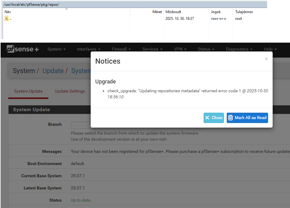

      So, the conclusion is that now adding an HW element (&/or change) deletes the files(??) from the /usr/local/etc/pfSense/pkg/repos folder

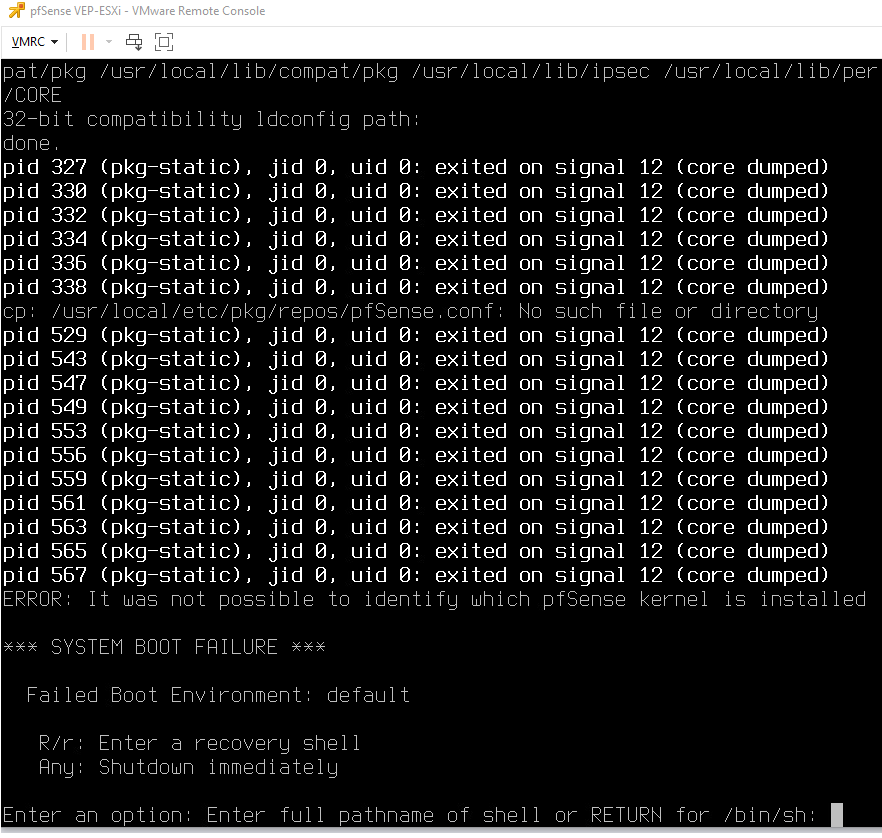

      After restarting again, pfSense will no longer start up.
      When this occurs, this error message is immediately displayed.
      check_upgrade: "Updating repositories metadata" returned error code 1 @ 2025-10-30 19:19:11

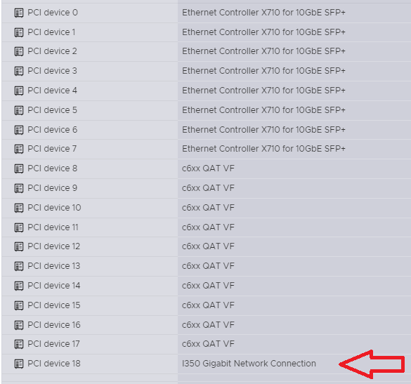

      In this state, there were 9 interfaces + VMware Tools installation. 4x X710 rNDC + 4x X710 rNDC + vmx0 for mgmt. (VMXNET3) + QAT 10VFs
      -----The "pkg" files were here in the folder----
      2. since it was necessary -- add an I350 with passthrough, - afterwards - REBOOT pfSense & ESXi host
      3. after restarting , the "pkg" files are missing and * Bug #16341 occurs immediately.*
      So, the conclusion is that now adding an HW element (&/or change) deletes the files(??) from the /usr/local/etc/pfSense/pkg/repos folder. hmmmm....?
      Does anyone have any ideas about this?

                I missed out a bit on this NDI and Plus license thing, but as I explained above, as soon as the added NIC created a new MAC, this license became invalid (so far, so good) and the firewall immediately threw up the error messages described in Bug #16341.
                After rebooting, it wouldn't start up again, and I had to continue from a snapshot.
