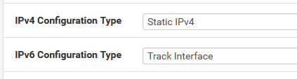

      I have set OPT1(renamed to NTP) to track the WAN interface's IPv6, using prefix 1(prefix 0 is used by LAN network).

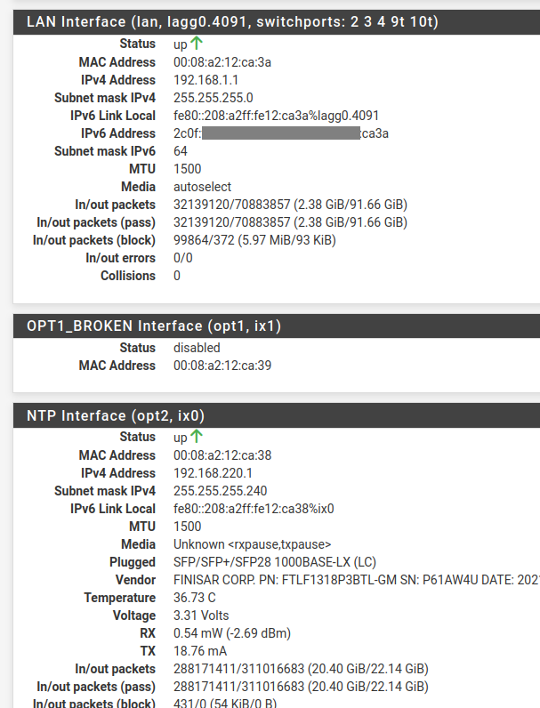

                      I reassigned IX0 interface from OPT1 to OPT2 and moved all my configs over to OPT2.
                      Now enabling IPv6 does not cause the firewall to go nuts. Something is confused with OPT1, as if something thinks the IP on OPT1 should match the WAN IP. And when it doesn't it reloads everything every 30 seconds.

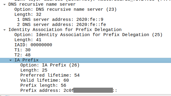

                          I did a packet capture. This has nothing to do with my pppoe connection.
                          My 7100 firewall is, every 30 seconds, sending an IPv6 DHCP renew request, and getting a reply from my ISP.
                          The Valid Lifetime is "60". I really hope that isn't 60 seconds?
                          Also, although I enabled IPv6 interface tracking, the OTP2 interface didn't get an IPv6 address from my ISP pool, and is handing out addresses from it's "local" pool. Unlike the LAN interface which got an IPv6 address.
