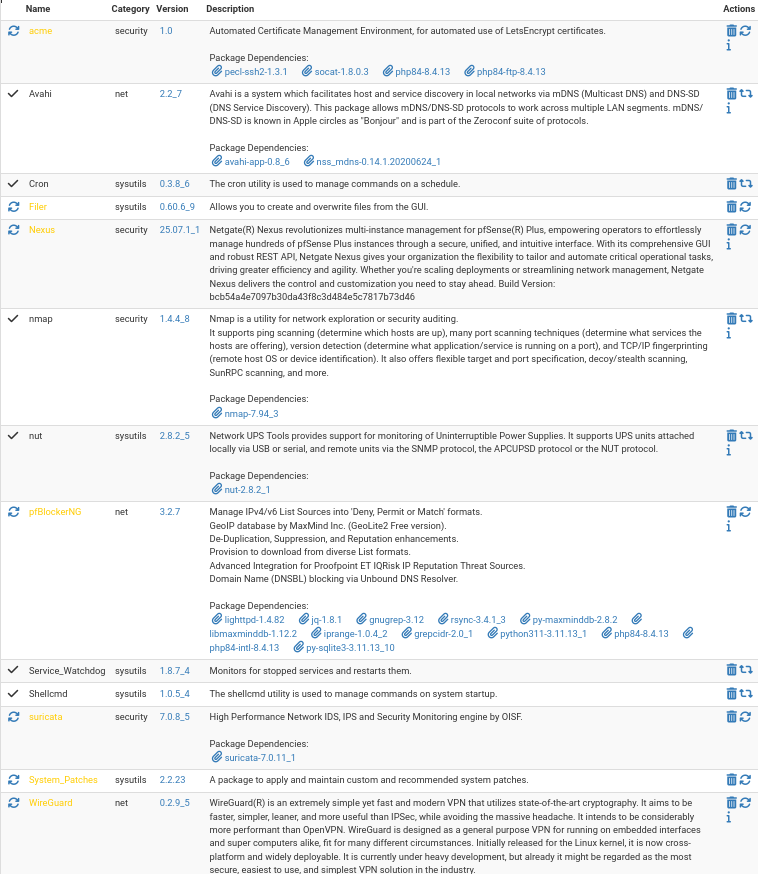

              • 4 Offline
                4o4rh @Gertjan
                @Gertjan that is what is says in the title. 25.07.01.
                the patches was a typo. current patches are 2.2.23
                if you click on the upgrade, you can see it shows the next version will be 2.2.24
                but then rolls back because of the PHP error, but if you look at the packages in the screenshot
                php should already be 8.4.13

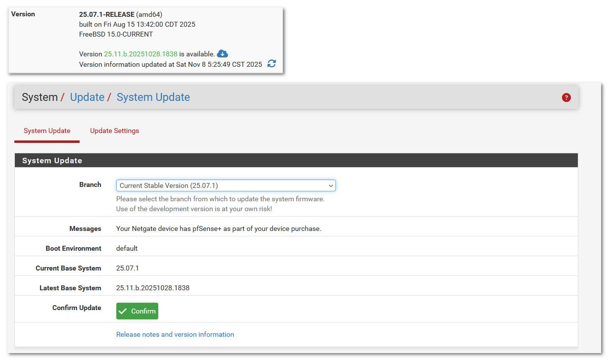

                    • GertjanG Online
                      Gertjan @Qinn
                      To @all
                      This is what I should see :
                      But ... when I visited this page initially, the "Latest Base System " proposed some beta named as a possible update, and the green Update button was there.
                      Or, I'm at the stable branche, not the 'dev' branch.
                      So : my 'conclusion' : something is happening.
                      So, for this weekend : leave things as they are 😊
                        mvikman
                        Feels like beta-repos got mixed into the stable release in the backend system...
                        pfSense Plus 25.07.1-RELEASE (amd64)
                        Dell Optiplex 7040 SFF
                        Core i5-6500, 24GB RAM, 2x 240GB SSD (ZFS Mirror)
                        HPE 561T (X540-AT2), 2-port 10Gb RJ45
                        HPE 562SFP+ (X710-DA2), 2-port 10Gb SFP+
                        GertjanG 1 Reply Last reply Reply Quote 1

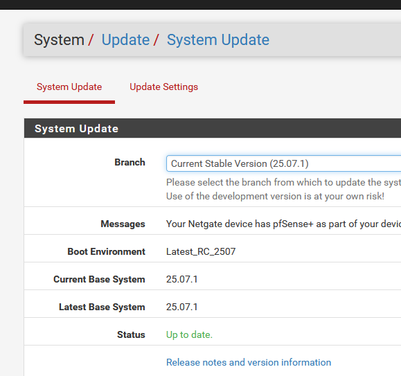

                        • GertjanG Online
                          Gertjan @mvikman
                          @mvikman
                          Something like that.
                          Not uncommon btw. Could mean nothing at all, as it could mean we wake up tomorrow morning with a new pfSense version, probably a RC1 candidate.

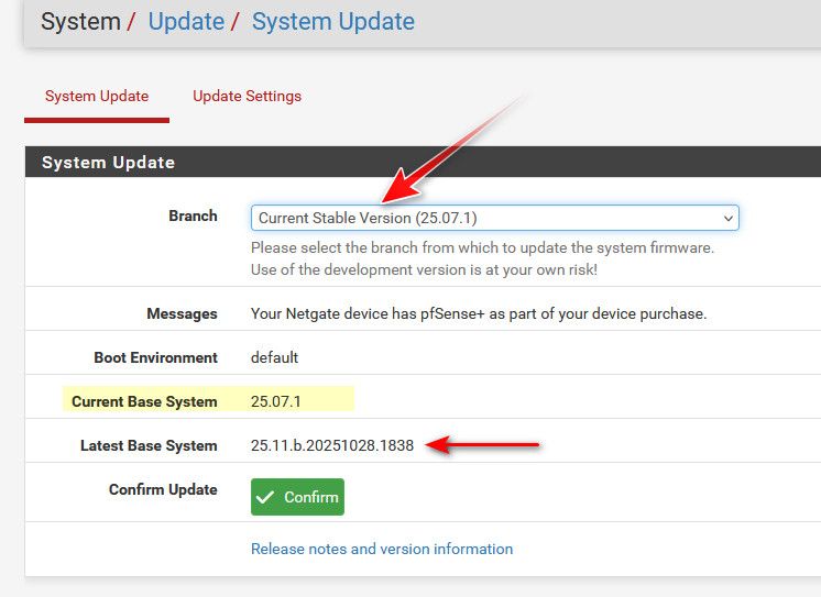

                            chime in - seeing the same thing - set for stable, but its like it wants to update to the 25.11 beta..
                            Something is goofy - tried toggling and saving.. Just seems stuck on wanting to update to a beta.
                              Are you still seeing it?
                              johnpozJ 2 Replies Last reply Reply Quote 0

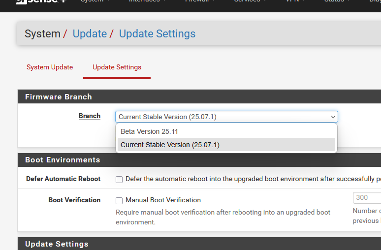

                                mvikman
                                Had to switch branch to beta and back to stable, seems back to normal for now

                                    @stephenw10 yeah did a bit of resaving that I was on stable - and seems to be back to normal now.
                                      @stephenw10 spoke too soon I guess - its back
                                      Had to go in and hit save again on update settings. To get it back showing stable 25.07.1
                                      edit: Then check a little bit latter and its back to the beta again.. Yeah something is borked.
                                        mvikman
                                        Yup, seeing the same.
                                        Though on my system dashboard said that beta update available, but the update page said no updates and Latest Base System was stable version. After a while with hopping between dashboard and update page, it started to show the beta as Latest Base System again.
                                          Yup, a change was still in place. It's now been reverted until we confirm the root cause.
                                          You should no longer see that.
