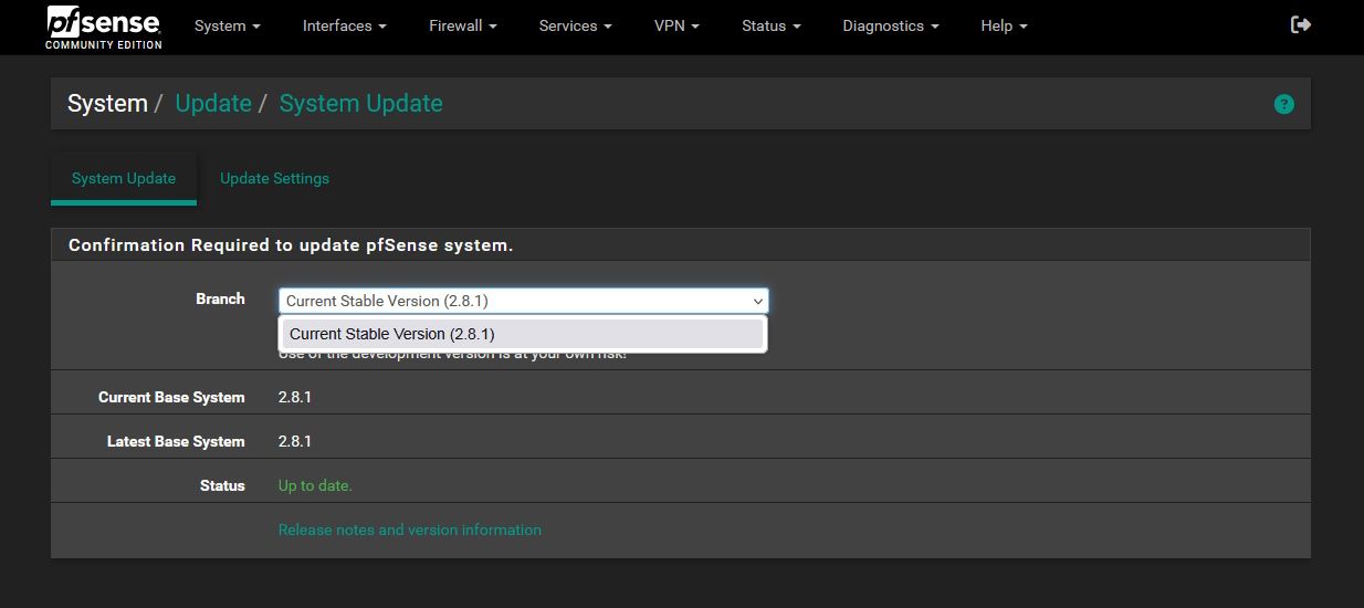

      When I go to the "Update" tab everything is correct showing as it should 2.8.1
      This is from Firefox with complete cleared history cookies en all.
      This box shown is not on +
      Anyone else seeing this?
      S patient0P 2 Replies Last reply Reply Quote 1
        SteveITS Rebel Alliance @chpalmer
        @chpalmer Which box, the entire Version section? It should always show.
        It looks like your device's NDI has a license for Plus so it's being offered...?

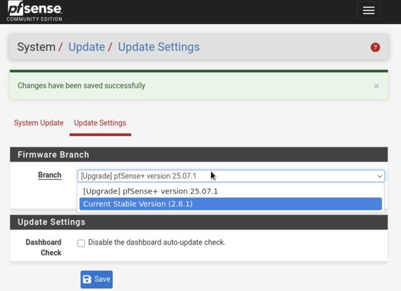

          @chpalmer I did a quick test on a 2.8.1 VM. Automatic update check is disabled. But if I change to System / Update / Update Settings I indeed get two channels, normal 2.8 and "[Plus] 25.07.1".
          A few minutes later (now) it's gone, guess a glitch in the Matrix :)

                        @chpalmer I started the same VM from yesterday again today and the Plus channel show up again.
                        But when I choose it, I can't do anything with it. And then if I check again, it's gone.
                        Only Netgate will know what they are trying to do.
