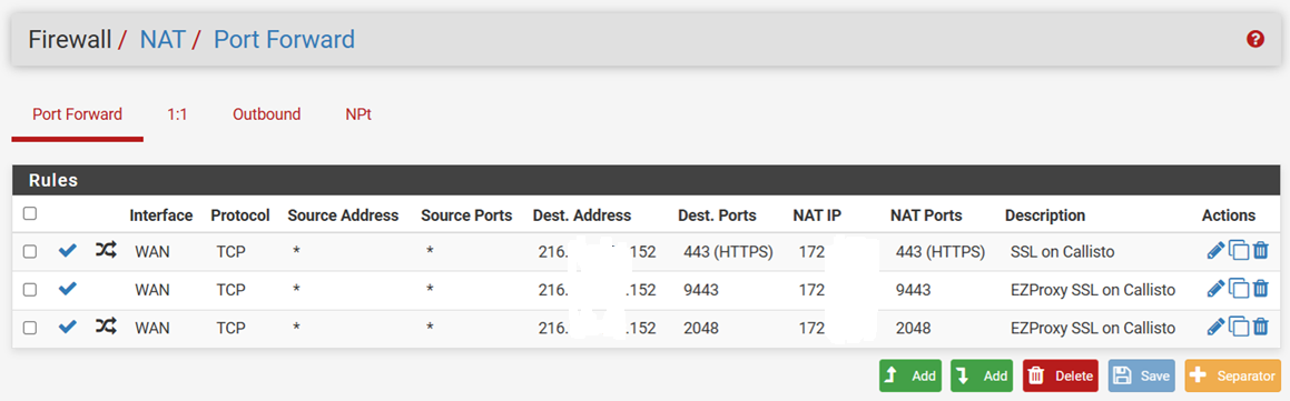

                Maybe just hit me and it's in your post title: the NAT rule.
                What does this NAT rule—assuming it forwards 9443-bound traffic to the EZProxy host (???)—look like? On what interface does it apply, etc.?

                  Nope. Different IP addresses internally and externally. Below is a screenshot of what's in NAT. As for EZProxy, it's something many libraries use to allow patrons access to resources normally only accessible from within the library. I could assign it a different IP address or move it to another server and go with the default 443 port, but everything's been working great until this which is now moot.
                  The destination public address is the same for the three entries; likewise, the NAT IP is the same internal address for all three. As for port 2048, it's a failover to accommodate those who may have bookmarked our old EZProxy links which used proxy by port.

                    1.) When you assign pfSense's GUI (called the webConfigurator) a port, it listens on all interfaces, including both WAN and LAN. Since most people never 'open' this port to inbound connections on the WAN interface, it typically never presents a conflict or a problem that the webConfigurator's nginx-based web server listens on all interfaces by default. (See this post for a recent thread on this point.)
                    2.) You have both:
                    • 'Opened' port 9443 on the WAN interface; and
                    • Crafted a NAT rule to forward any/all inbound 9443-destined traffic arriving on the WAN interface, to be 'redirected' to the EZProxy host that I'm assuming is not homed to 172.16.0.1
                    3.) At some later point, you changed the webConfigurator's listening port to 9443. It would not have been readily apparent at that time that inbound 9443-destined traffic arriving on the WAN interface now had two potential and conflicting routes to take: the webConfigurator webserver, and the EZProxy LAN host.
