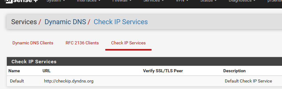

      Hi, is the dyndns script in pfsense aware of ipv6 vs ipv4 when calling a checkip service? My experience is that things are breaking when adding an ipv6 aware checkip service.
      Also, it would make sense to allow the use of a configurable checkip selection in the settings of a dyndns entry, this way v6 dyndns entry could be connected to a v6 checkip service.
          When you add you're own, be sure it can handle both.

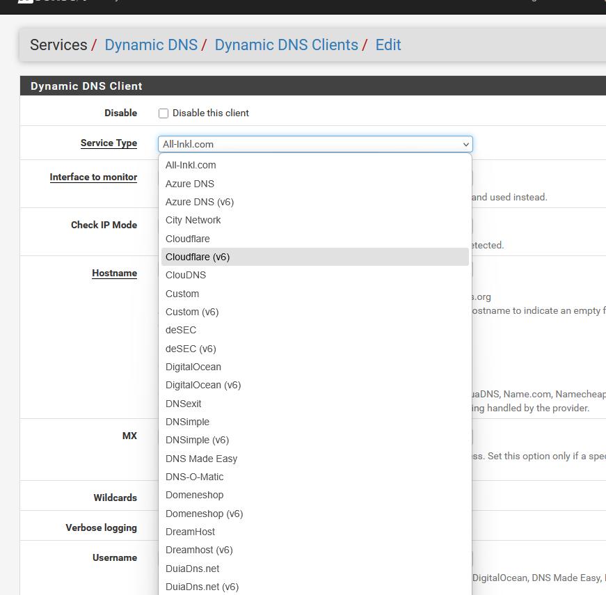

            I'm aware how to configure the dyndns part for ipv6 addresses, at another location I have it working when inferring the public address from the WAN interface (ie: not using the checkip service).
            Here's what I have done:
            1. setup a dyndns entry with Azure v6, enabled verbose logging
            2. added a checkip service, https://6.ident.me and disabled all other checkip services
            SSH'd into pfsense, ran /etc/rc.dyndns.update and here's what's in the log:
