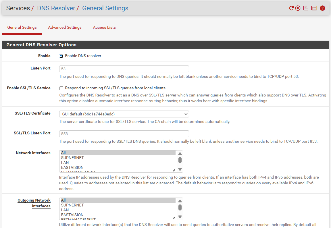

        Check if unbound listens on all you interfaces :
        [25.07.1-RELEASE][root@pfSense.bhf.tld]/root: sockstat | grep 'unbound'
        unbound  unbound    64723 3   udp6   *:53                  *:*
        unbound  unbound    64723 4   tcp6   *:53                  *:*
        unbound  unbound    64723 5   udp4   *:53                  *:*
        unbound  unbound    64723 6   tcp4   *:53                  *:*
        which means : all interfaces, UDP and TCP, port 53.

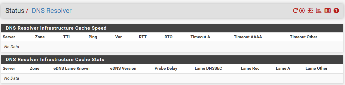

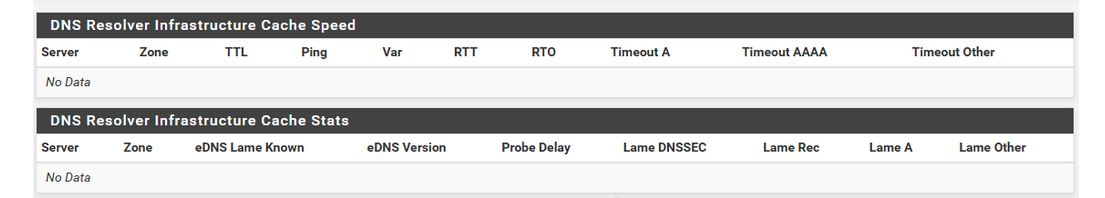

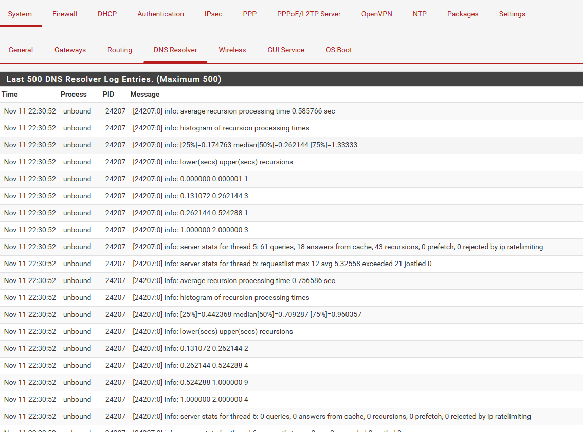

        This :
        Hummm. That list can't be empty.
        I've got thousands of entries in that list.
        Did you transform the Resolver into 'dumb' a forwarder ? (so, technically, unbound doesn't do any resolving anymore, it just forwards to where ever you want to send your DNS traffic to = 8.8.8.8 etc)

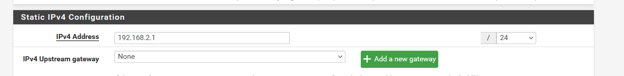

              This is one of my extra LAN :
              Can you show one of yours ?

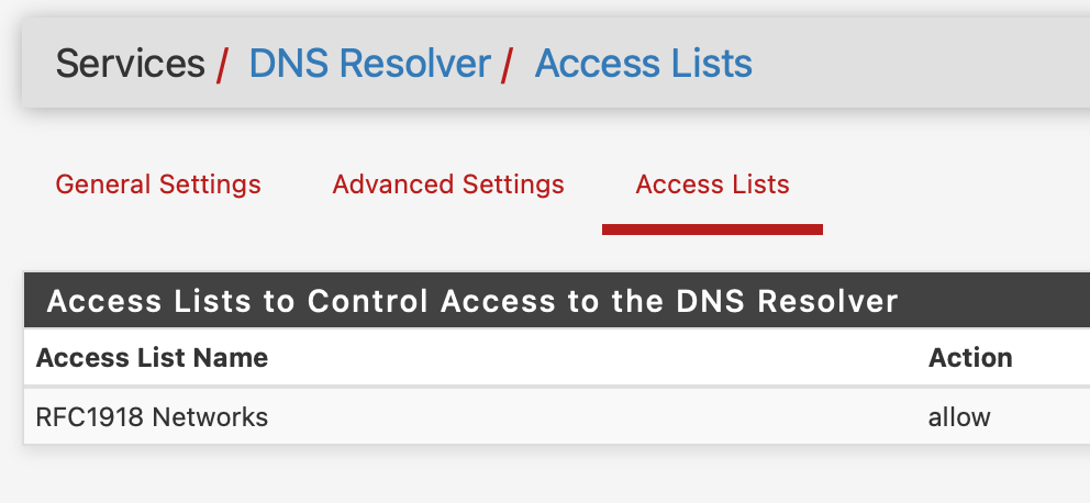

                Averlon @ayansaari
                @ayansaari Check your ACL configuration to see what IP Ranges are allowed to use the resolver service
