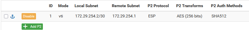

      Here is the tunnel with both routes active:
      "Remote" only shows the 20-net, because the 1-net was not enabled as a "local subnet" on the Sophos side.
      As soon as I enable the second subnet "Remote" only shows 192.168.1.0/24 (instead of both networks).

        @HyperactiveSloth That does not look like a VTI tunnel to me, but rather a policy routed tunnel. If that is the case, then your problem could be that you need to enable “split connections” on your phase one tunnels advanced settings.
        It sound like the box in the other end does not support multiple traffic selectors in one phase two.

            @HyperactiveSloth Hmm, my VTI tunnels status shows 0.0.0.0/0 as the network in both ends in order for me to assign what traffic goes down the tunnel (by assigning routes to the VTI Gateway created when the IPsec interface sis assigned).
            Your IPsec status looks like a tunnelmode Phase 2, where the local/remote subnets are assigned in the Phase 2 settings.
            Strange…. If it was tunnelmode I’m quite sure your issue is the “missing” split connections setting….
