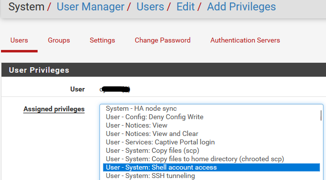

so where do i grant the user the ability to log-in ?There isnt a System -> User -> Shell
There also an ability to provide shell access to a user under the users account. -
@michmoor Edit the user, and in the "Effective Privileges" section, click Add, to get to:
This post is deleted! -
@SteveITS that.........did it.

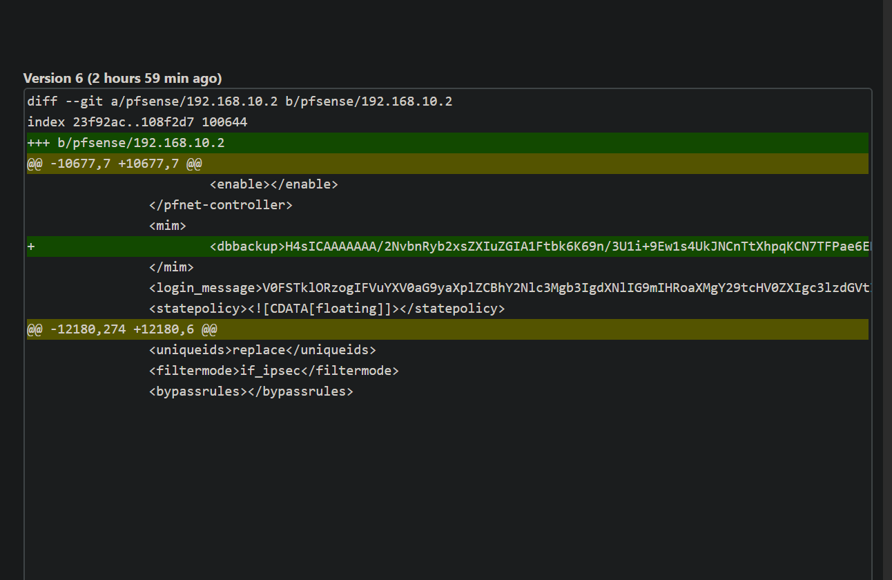

oxidized:*:2000:65534::/home/oxidized:/bin/tcshOnly with this lab firewall did i have to specifically grant SSH access. Super strange. But its working for now
I do wonder if this is some pfnet weirdness. Now that i am able to view diffs, the only change made today was disabling Nexus.
