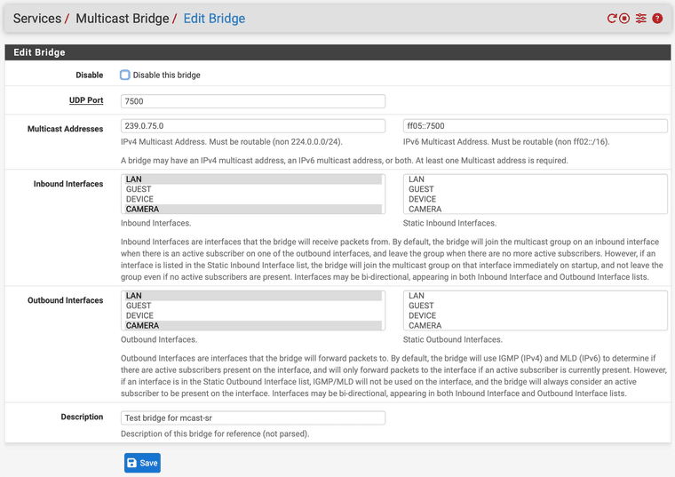

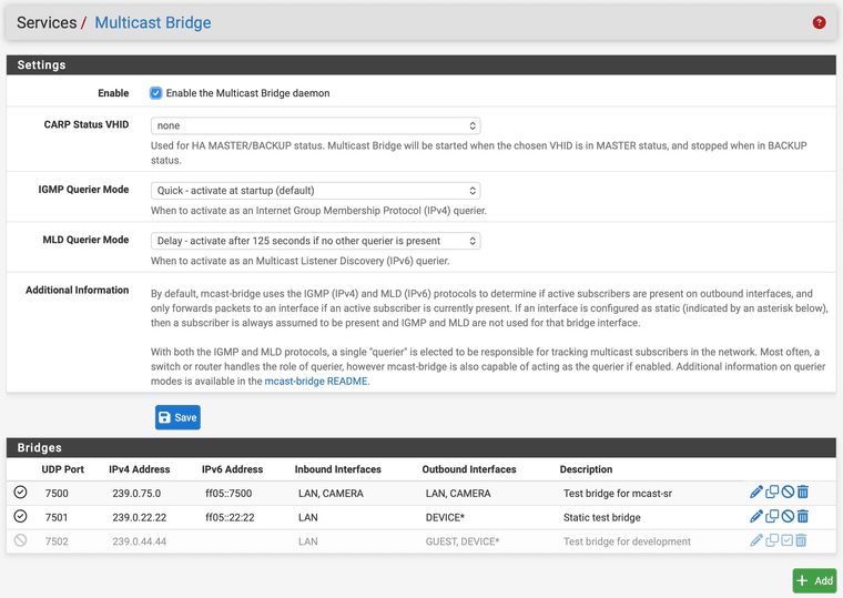

        If you are interested to see the package for Multicast Bridge, you can find it here. I've also included a couple of pics below.
