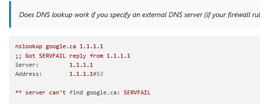

      Does DNS lookup work if you specify an external DNS server (if your firewall rules allows it) like nslookup google.ca 1.1.1.1
      ;; Got SERVFAIL reply from 1.1.1.1
      Server:		1.1.1.1
      Address:	1.1.1.1#53
      ** server can't find google.ca: SERVFAIL

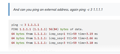

      @patient0 said in Specific client suddenly cant access the web but can reach LAN clients or gateway:
      And can you ping an external address, again ping -c 3 1.1.1.1
      ping -c 3 1.1.1.1
      PING 1.1.1.1 (1.1.1.1) 56(84) bytes of data.
      64 bytes from 1.1.1.1: icmp_seq=1 ttl=59 time=3.19 ms
      64 bytes from 1.1.1.1: icmp_seq=2 ttl=59 time=2.66 ms
      64 bytes from 1.1.1.1: icmp_seq=3 ttl=59 time=3.10 ms
      --- 1.1.1.1 ping statistics ---
      3 packets transmitted, 3 received, 0% packet loss, time 2003ms
      rtt min/avg/max/mdev = 2.663/2.985/3.192/0.231 ms

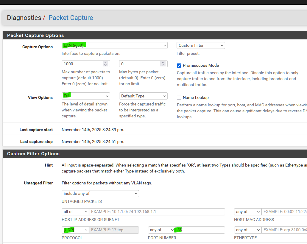

        Repeat the "nslookup google.ca 1.1.1.1" command, but before hitting enter, set up a packet capture on pfSense :
        where, instead of "LAN" you chose your 192.168.210.1/24 network/interface.
        Be ware : a lot of traffic will show up.
        It's probably wise to enter the IP of your media device as a filter criteria so only DNS traffic from this device will be captured. You can do that here :

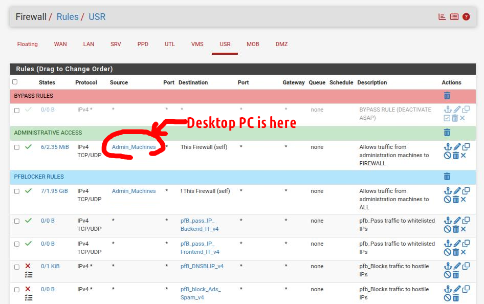

            I confirm the issue is on pfsense and not on the "faulty" client because I moved a laptop to this subnet and bingo its the same issues. I also noticed the same issue on other subnets so definitely a larger issue than I thought.
            Basically only my desktop PC continues functioning propery because it is included in a firewall alias which has a pass ALL rule on its subnet (see screenshot below). Why this issue started yesterday and all was fine for over a year now? Who knows...

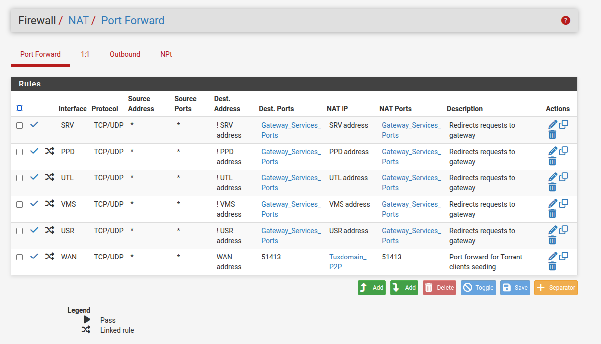

            @johnpoz said in Specific client suddenly cant access the web but can reach LAN clients or gateway:
            That screams he is doing interception of dns, and where he redirects it to had a failure, and returned to the client the error.

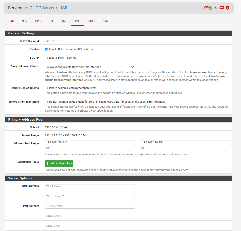

            OK time for some pfsense details:
            Subnet DHCP:

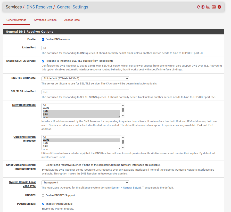

            System DNS:

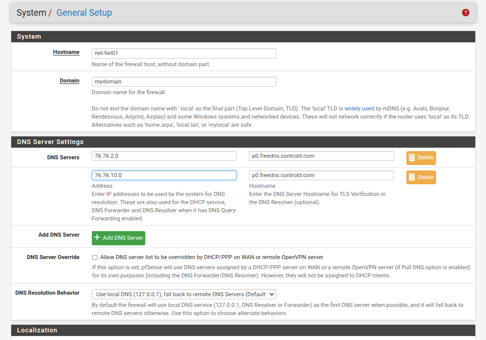

            DNS Forwarder: DISABLED
            DNS Resolver:

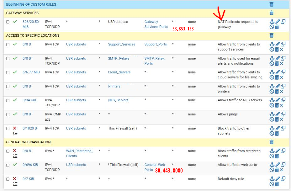

            Firewall rules on the subnet where the "faulty" client (and my desktop PC) are:
            NAT rules:

            See above, my desktop PC has a "special" place (i.e. bypasses everything in FW).

              IN the DNS resolver logs, I see a lot of the following, not sure if related or not to my isues:
              Nov 14 13:33:47	unbound	45122	[45122:1] error: ssl handshake failed crypto error:0A000086:SSL routines::certificate verify failed
              Nov 14 13:33:47	unbound	45122	[45122:1] error: ssl handshake cert error: hostname mismatch
              Nov 14 13:33:47	unbound	45122	[45122:1] notice: ssl handshake failed 8.8.8.8 port 853
              Nov 14 13:33:47	unbound	45122	[45122:2] error: ssl handshake failed crypto error:0A000086:SSL routines::certificate verify failed
              Nov 14 13:33:47	unbound	45122	[45122:2] error: ssl handshake cert error: hostname mismatch
              Nov 14 13:33:47	unbound	45122	[45122:2] notice: ssl handshake failed 8.8.8.8 port 853
              Nov 14 13:33:47	unbound	45122	[45122:1] notice: ssl handshake failed 1.1.1.1 port 853
              Nov 14 13:33:47	unbound	45122	[45122:2] notice: ssl handshake failed 1.1.1.1 port 853

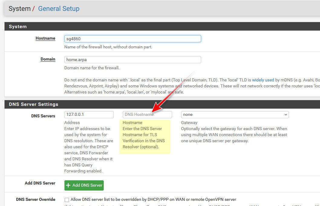

              Not sure if this will help but last year when I configured pfsense my intentions were to "intercept" DNS requests (both from 53 & 853) from the clients and redirect to their gateway IP (subnet IP) so pfsense can handle the DNS requests via the DNS servers specified in the general setup page...
                johnpoz LAYER 8 Global Moderator @pftdm007
                @pftdm007 you trying to do dot forwarding.. That looks like a problem trying to create your dot connections with google and cloudflare.
                Did you put the hostnames in when you set up the forwarding?
                If me I would tear that down and just let unbound resolve normally - once that is working again, you could redo your dot forwarding if you want.
                But you can not intercept dot traffic (853).. The whole point of dot and doh is validation your talking to who you are thinking your talking to - so you would have forge your cert to use their names, etc. And clients don't normally use dot (853) they use doh (443).. Name servers are normally the things that use dot - to forward to other name servers.

                  @johnpoz OK I removed all the NAT rules and removed all traces of firewall rules that were auto-created.
                  I manually created a rule allowing traffic (TCP/UDP) from subnet (all ports) to 192.168.210.40:53 (hoping DNS resolution using the gateway's IP will be allowed).

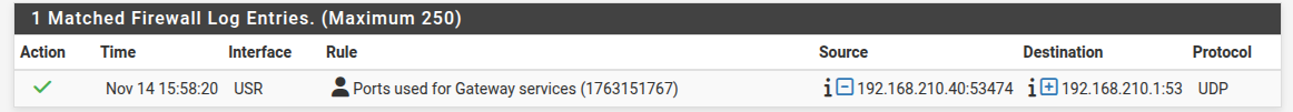

                  I think traffic to gateway on port 53 works because if I try "nslookup google.com 192.168.210.1" on the "faulty" client I see:
                  If I try "nslookup google.ca 1.1.1.1" on the "faulty" client I see :
                  Which makes sense because the FW rule is configured to allow only traffic on port 53 going to the gateway's IP, nothing else (1.1.1.1 or whatever...)
                  (Gateway_Services_Port alias = 53,123)
                  Then I removed port 853 from all aliases/rules.
                  I think this is as simple as it can be, but it still doesnt work.
                  In the pfsense FW logs I see tons of blocked traffic to 224.0.0.251:5353 but I believe these are multicast DNS which AFAIK I dont use...
                  I looked in my config logs this pfsense machine has been last modified 8 months ago. Everything was just fine until yesterday. Thats frustrating to say the least...

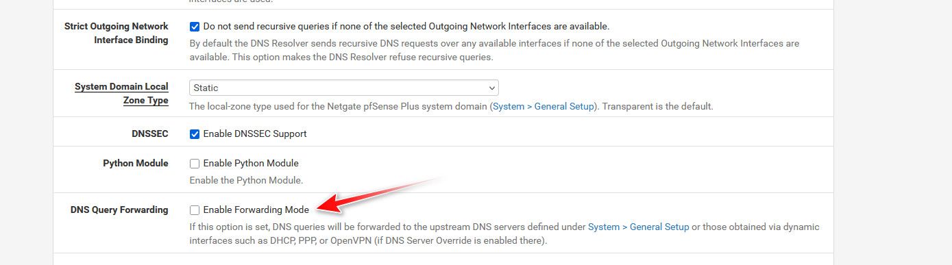

                    @pftdm007 did you change your unbound to not forward - that is where you major problem is. Your trying to forward to google and cloudflare - and its having an issue trying to do dot (853) because your hostname is not matching..
                    You need to setup the hostname here
                    If you are going to do dot forward.
                    But I would just turn off forwarding completely - until you get dns working.
                    P 1 Reply Last reply Reply Quote 1
                    • P Offline
                      pftdm007 @johnpoz
                      @johnpoz OK now its working.
                      TO be honest I am not sure what happened between 2 days ago and yesterday for all of my setup to bug up like that.
                      If I understand correctly, now with FW mode disabled in unbound, things work a bit like this:
                      • Client gets an IP from pfsense
                      • Pfsense informs client of the IP to use for DNS resolution (in my case the gateway IP)
                      • Client wants to resolve something.com, it sends the request to the gateway's IP on port 53
                      • pfsense gets the request and passes it to unbound
                      • unbound resolves the domain name using the DNS servers configured in pfsense's general setup page
                      • pfsense returns the resolution to the client
                        @pftdm007 not quite - if you are not in forwarder mode, unbound resolves what was asks from the roots down.. It doesn't send the query anywhere - it resolves vs forwards.
                        And not so much pfsense passes it to unbound, unbound is listening on 53, and as long as your firewall rules allow it - unbound will get the query directly.
                        When you resolve - you don't need anything in the general setup at all. If pfsense itself needs to resolve something it will ask itself (unbound) via the loopback address 127.0.0.1
                        the only time something like 8.8.8.8 would be used if you have it in general is if pfsense itself wanted to lookup something and unbound wasn't answering. Or you were in forwarding mode, be that either native (just 53) or in dot mode (853 with encryption of the connection via tls)
                        Now that you know normal dns works - you could go back to forwarding if you want. I personally not fan, but sure if you want to forward forward.. Only thing I would suggest if you forward is uncheck to do dnssec. It can only be problematic if you forward - where you forward either does dnssec already or it doesn't, if it doesn't telling unbound to do dnssec is just going to cause extra queries, and could cause problems.
                        Also forwarding to different services can be problematic as well - especially if they do filtering, and the filtering could be different. Since you don't really know which one will be forwarded to when you have more than 1 service.. You are not sure which filtering you would get.. Its best if you forward to pick 1.
