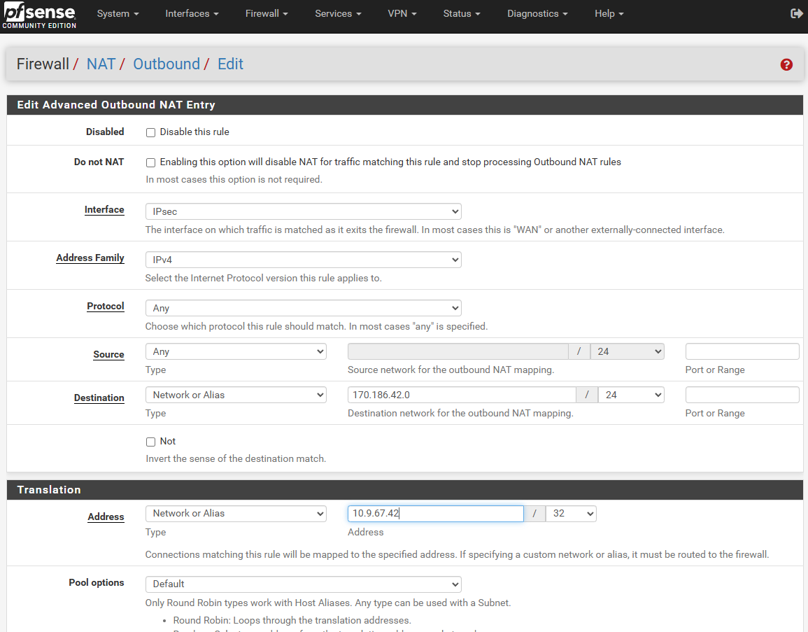

      • an outbound nat rule:
      • NOTE: i did try changing the interface to ipsec, or vti, loopback, lan with the same result*
      with this configuration, it was not working at all... i have checked the states, did debug with tcpdump and the other side was not receiving anything from my source (10.9.67.42) but vti tunnel could ping and such.

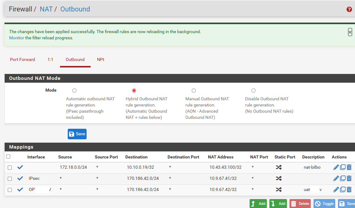

      after a few weeks, we came back to this topic and did the same configuration but we changed the tunnel to ikev2 and instead of translating to 10.9.67.42 we changed it to 10.9.67.41 as the customer requested.
      so here is the thing that i dont know if is a bug, or a feature or if im just lost =)
      since we had another ip to present ourselves towards the client, i added another OUTBOUND RULE...
      and suddently, it worked like a charm (Unintentionally)...
      At first glance i said, "oh with ikev2 works, fine" but today i was checking some connections in the nat table, and i found this:
      my firewall was doing a chain of nats, and that was allowing me to reach the other side...
      if i disable any of the rules, it will stop working... and if i change the interfaces of the nat to use ipsec or opt in both rules it wont work as well... Also notice that the one with the opt interface is the one that will dictate the ip that will see my customer on the other side.
