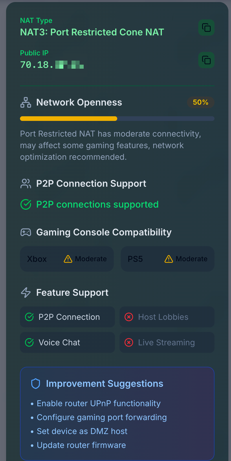

          @luckman212 EIM may not be sufficient because as I understand it EIM only deals with the mapping. There is still the matter of allowing (e.g. inbound) connections through the filter which UPnP helps with. FWIW I didn't see the Switch 2 even try UPnP. With EIM (no port forwards, static port unchecked) it showed NAT Type B, without EIM it showed NAT Type D.

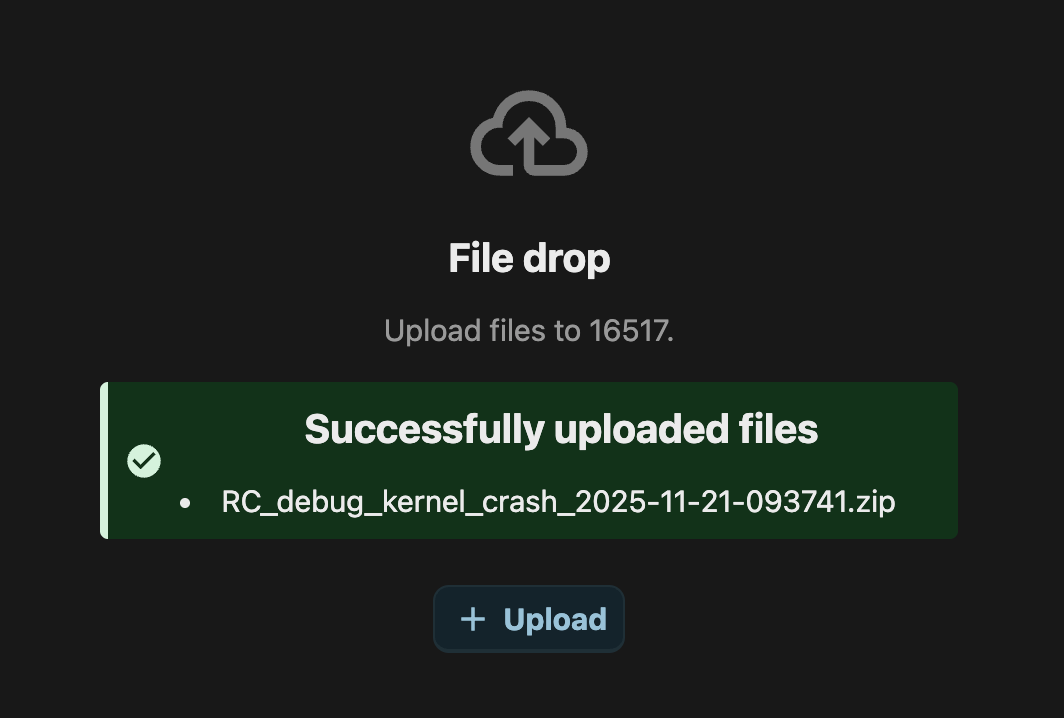

                    @marcosm I just replicated the crash on the debug kernel and uploaded the dump to nextcloud. Hope it helps.
                    If this panic can't be fixed in kernel then at least Input Validation should block users from clicking both EIMNAT + Static Port...
                      marcosm Netgate
                      That matches the crash we reproduced. It will be fixed in the release.
