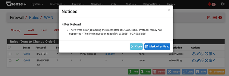

    pfSense 25.11RC does not like IPv6 turned off?

                  @stephenw10 I'm getting this too on a 3100 running 25.07.1

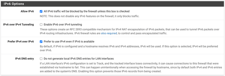

                  I've skimmed over the rules.debug but don't see anything that jumps out. Also tried disabling Allow IPv6 on Advanced settings but it had no effect, the error still presented.
                  My settings...

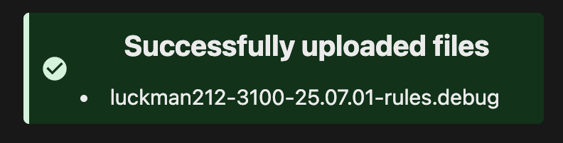

                  I uploaded the rules.debug to the same drop:
