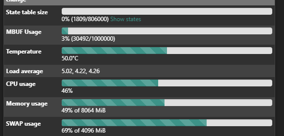

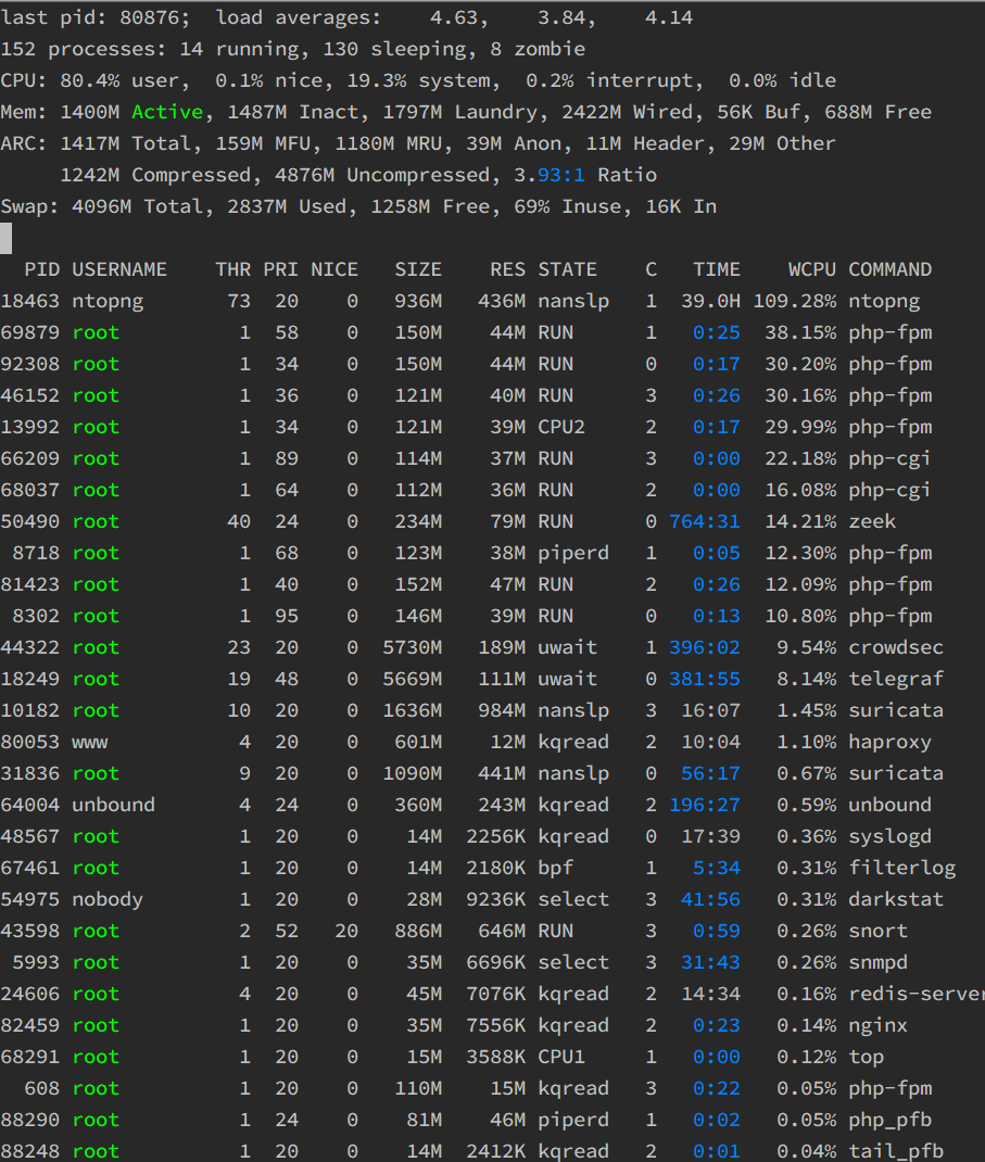

      I am using a SG6100-Max with a lot of services enabled. I've noticed that my CPU usage is quite high from 40% to 100%. My 1GB swap space was always 100% full, so I increased it to 4GB. Traffic is homelab setup.
      Is there something I can do to address the issue/tweak it further?
      These are the settings:
      Netgate 6100-Max
      8 GB RAM (onboard so can't upgrade)
      128GB HD
      Packages:
      Top snapshot:
      CPU Memory and Swap:
      Can I tweak it any further such as increasing the swap space?

            The amount of CPU for ntopng is quite egregious. I would suggest you reconfigure (or disable) ntopng. You likely have it tracking more data than it should be. Recommendations...

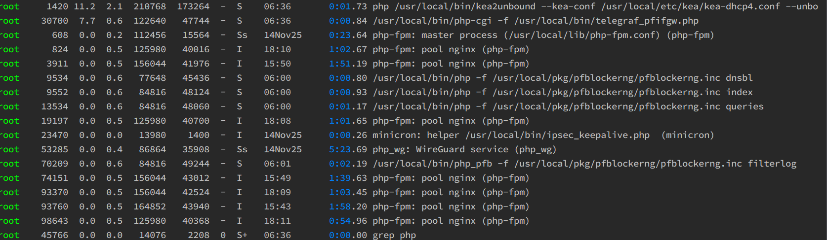

              @alnico Run ps aux|grep php and see if you can see what the PHP processes are actually doing. Often those are stuck doing log rotation/compression, which can be a few things...double compression, high log amounts, etc.

                @SteveITS
                This is what I have, but I can't tell what they are supposed to be doing. Are the dates meant to refresh, or are old dates acceptable?
                S dennypageD 2 Replies Last reply Reply Quote 0
                  SteveITS Galactic Empire @alnico
                  @alnico The date there is when the process launched.

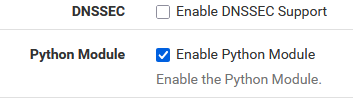

                  kea-dhcp, unbound
                  Is DNS Resolver set for Python mode?

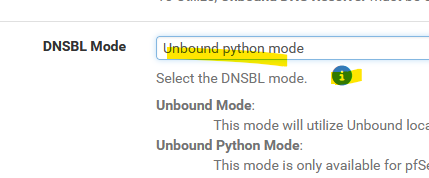

                  and then if using pfBlocker DNSBL, set:

                    Given that your original post shows ntopng at 39 hours of cpu, I think everything else is probably minor in comparison. As a starter, I would suggest disabling ntopng completely while you evaluate the rest of the system.
