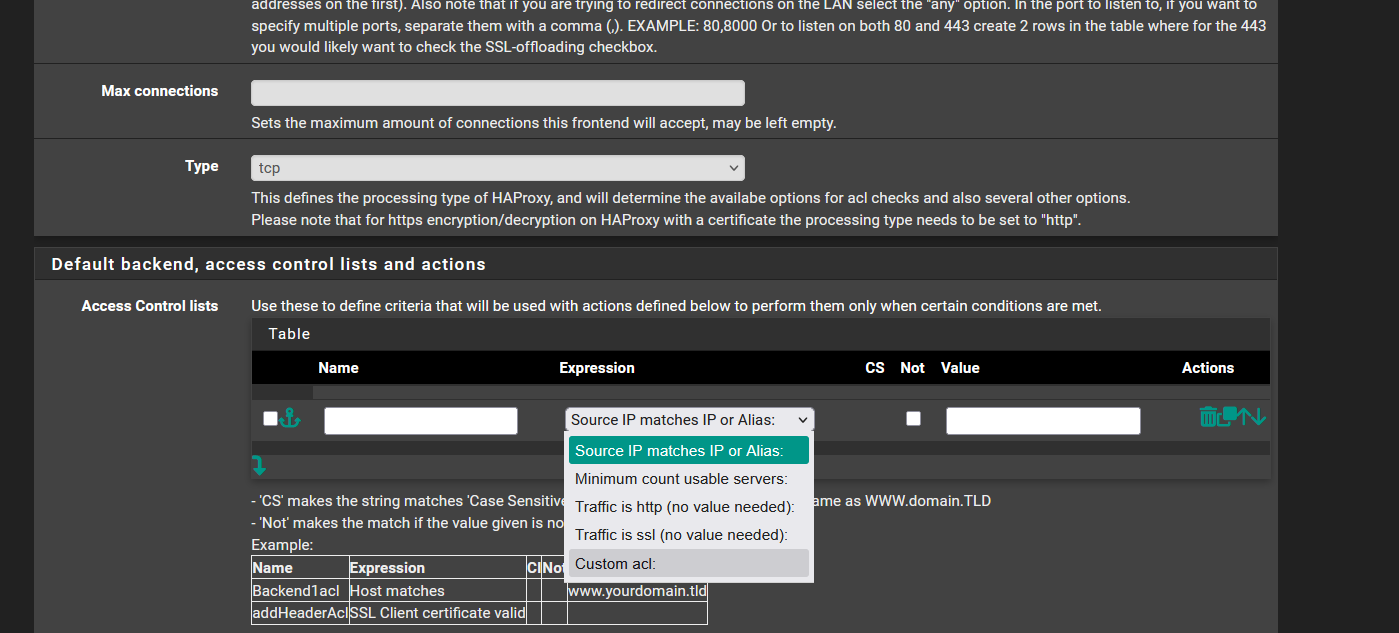

@louis2 tcp is your option, ie 3.
And then use acl's as seen in examples.
Since this is a networking forum, we tend to use the term routing in a strict context.
afaik, the haproxy implementation has the same options as the open source version, albeit the web interface isn't exploring many of them in an intuitive way.
When using tcp as type, the shown acl options in the gui do not match what I need (selection on host or IMHO domain).
What comes near as example is
https://www.linode.com/docs/guides/how-to-configure-haproxy-http-load-balancing-and-health-checks/where path and not host is used as criteria and http as type which is not available in the pfSense HA-gui
How about custom?
and then an action.
Yes it is not intuitive or easy, and no, I don't have that much experience on that, but the options exist.
