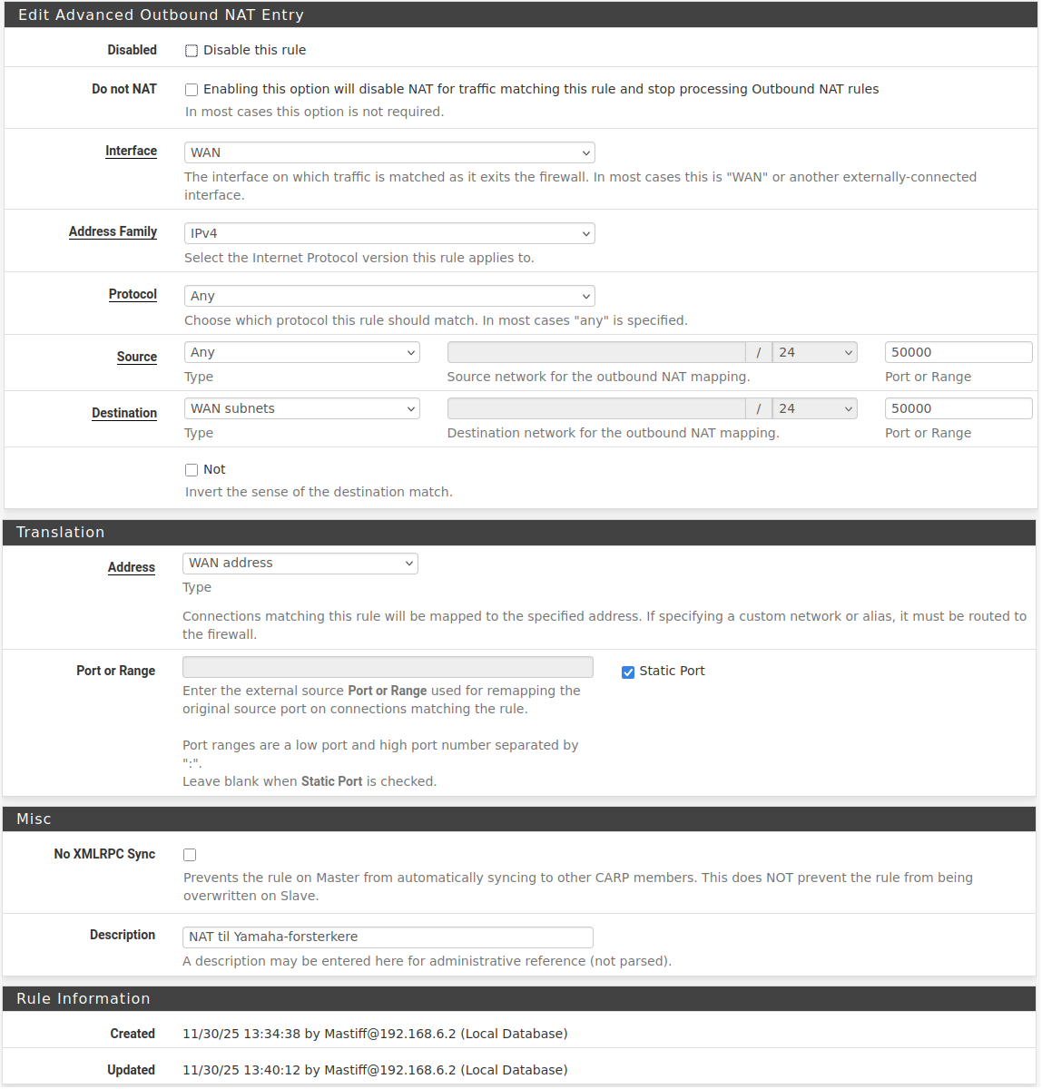

      Something about using RFC1918 on both the WAN and LAN interfaces may require particular static routing and/or reconfiguration of pfSense settings (e.g., Interfaces / WAN / Block private networks and loopback addresses).
        Mastiff @johnpoz
        @johnpoz As I said in my first message, this is a pfSense on my "outer" LAN, which is defined as WAN in it, that routes traffic to Home Asistant, and only the traffic I want there. So it's not a real WAN.

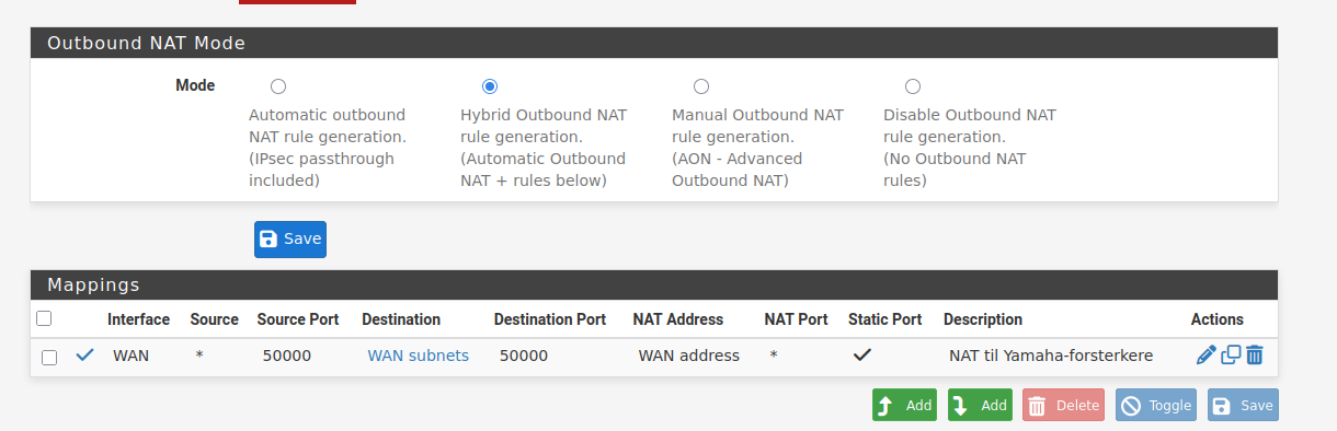

        @tinfoilmatt I have already removed the tick in "Block private networks". And this one plug-in is the only thing that has problems, MQTT, SCRAPE sensors on port 8880-8889 and about ten other services and maybe 50 devices have no problems getting back and forth. Which is why I am not understanding this at all.

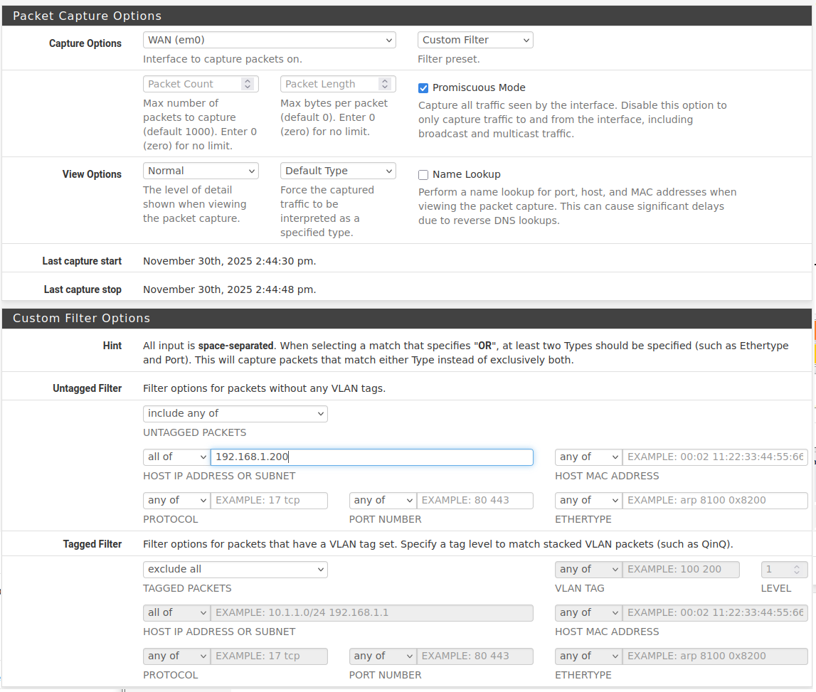

          @Mastiff Can you show your packet capture settings?

                Here are the rules for capturing:

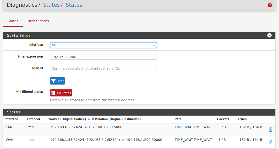

                      But that doesn't account for the Yamaha receiver's default gateway not being 192.168.1.53.
                        Mastiff @tinfoilmatt
                        @tinfoilmatt Correct, that's 192.168.1.1.
