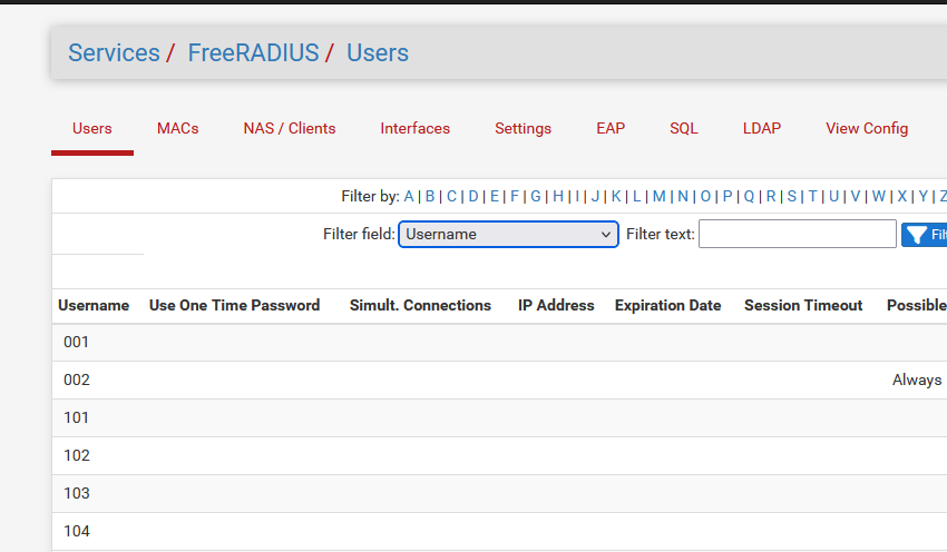

        Have a look at this file : /usr/local/etc/raddb/mods-config/files/authorize
        When you see the file, you'll think : where did I see this before ?
        It's the info you entered here :
        Start by checking all the entries : remove accented chars, all ' " `` etc. Just plain ASCI text.

        But you kept your freeradius settings with an error in place ^^
