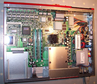

      The X Peak hardware is as standard (at least in my X6000):
      Pentium 4 2.8GHz (SL6PF), 512MB in two 256MB DIMMS, 128MB compact flash card (Sandisk 'industrial'!).
      3X Intel 82547GI Gig Ether, 7X Intel 82551ER 10/100 Ether, USB 2.0, 2X DB9 Com ports.
      Intel FWE6300ESB 875p chipset
      The motherboard is an Advantech AIMB-X3 (Rev.A1 in my case).
      The PSU is a Seasonic SSF-160U1
      It has an unfilled mini-pci slot and a space for a hard disk caddy with a spare IDE connector.
      Front mounted LCD and cursor controls.
      In other words quite a tasty piece of kit!  :D

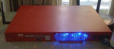

      The front Panel.
      Inside the box

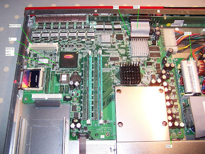

      The motherboard
      The board has a LOT of extra connectors and unpopulated pads. I've labled those which have pins to avoid any confusion. CN24 is under the ribbon cable leading to the LCD. CN42 looks like a spare fan connector. It's hard to say which pins are CN11,12 and 14. The labling on the board practically non-existant and there's no mention of it on Advantech's site.

      It loud!  :o It has three 40mm fans running flat out all the time. No thermal control.

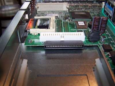

          When you say you needed an adapter do you mean a 2.5" to 3.5" ATA cable?
          Something like this:
          Did you boot the CD in the laptop first or directly in a drive connected to the Firebox?

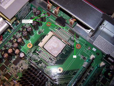

            I took off the heatsink assembly, which seems massively engineered.
            There seems to be three fan connectors on the board as well as the seperate fan assembly PCB. Probably just a parallel set of connections.
            More interesting is J1. A set of 25 pins (2X13 with one missing). The fact that it's labled as a jumper and not a connector is intersting. There are no jumpers on it though. Perhaps a CPU speed selector? I thought that would all be done in the bios on this era of board. I wish someone at Advantech had bothered to lable all this!  >:(
            • stephenw10S
              Ah!
              Did you in fact mean something more like this?:
              Which looks like it would fit in here:

                  Yes, this second adapter you show here is similar to the one I used.

                              The device in the post: Vendor ID 16AE; Device 000A would seem to be a Safenet SafeXcel 1841. It seems that it should be supported under FreeBSD but isn't recognised. It's the larger of the two chips with silver heatsinks (the other one's gig ether) and runs quite hot.
                              Update: It isn't supported in the safe(4) driver from FreeBSD 7.3 or 8. However..
                              Prices for the SafeXcel-184x series start at $85 per chip in quantities of 10,000
                              Sweet! I'm prising it off and selling it!  ;D

                                I just swapped the processor for a Pentium 4-M (SL6FH). It's rated at 1.8GHz but because the board doesn't support speed step it defaults to it's lower speed of 1.2GHz. The board booted and ran fine using slightly less power, ~46W at idle.
                                It does seem that there may be some potential for a pin mod to make it run faster.
                                However looking at the output of mbmon the core voltage being supplied by the board is 1.57V when it should be 1.3V.  ::) Not good! The chip does have a far higher rated junction temperature though so could be run hotter. Still 1.57 is actually higher than the voltage provided for the original P4 so I think we can assume that the bios knows nothing about the P4-M. A Shame.  :(
                                Bios access is still defeating me. I can now semi-reliably get the first part of the POST which helps when swapping CPUs.
                                I am left thinking that the bios module that supports console access is basically knackered and was never meant to be used. I've tried every combination serial settings and several cables. I even installed a serial sniffer to watch what was actually being sent and received. It seems that the bios is just not receiving/interpreting what I'm sending correctly. Looking at instructions for other motherboards of the same era with the same bios modules and chipset it seems that it should just work with no problem.
                                Update: I got braver and went for the pin mod I linked to above. Removing pin AE1, or bending it as I have, reduces the core voltage by 0.4V. So far it seems stable and cooler. ~42W at idle.
                                [1.2.3-RELEASE]
                                [root@pfSense.local]/usr/local/bin(17): ./mbmon
                                ioctl(smb0:open): No such file or directory
                                Temp.= 35.0,  7.5, 37.5; Rot.= 21093, 21093, 19852
                                Vcore = 1.15, 2.16; Volt. = 3.38, 5.05, 12.10, -12.04, -0.62
                                Should be able to fit quieter fans now for sure.

                                      Here's a quick pic. I'm a sucker for a blue LED!  ::)
                                      • J
                                        jaime
                                        looking nice, I would most likely use red LED instead to match the case and my other computer fans (I like to have some kind of color coordination and contrast lol) nice job!
                                        • stephenw10S
                                          Thanks Jamie.  8)
                                          Oooo red, now there's an idea! It's a tough call though. Plenty of red led fans, plenty of 40mm fans, plenty of quiet fans but all three in one fan? I've not found one. To be honest you won't see it anyway once it's installed.  :D
                                          • J
                                            jaime
                                            i know, but the glow in the dark room…thats worth it :)
