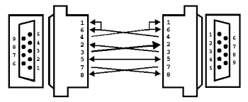

          Interesting, following your post I've just checked the cables, here's what I've got:
          female/female:
          5 4 3 2 1
          9 8 7 6
          and the Male/USB
          1 2 3 4 5
          6 7 8 9
          So my cables are not fitted which might be the cause of the problem I guess.
          I'm a bit lost, never really knew about serial cables pins before.
            Metu69salemi
            Hope this helps
            and something  to read
            • F Offline
              famas54
              My female/ female has exactly the same scheme. Thanks for the explanation
