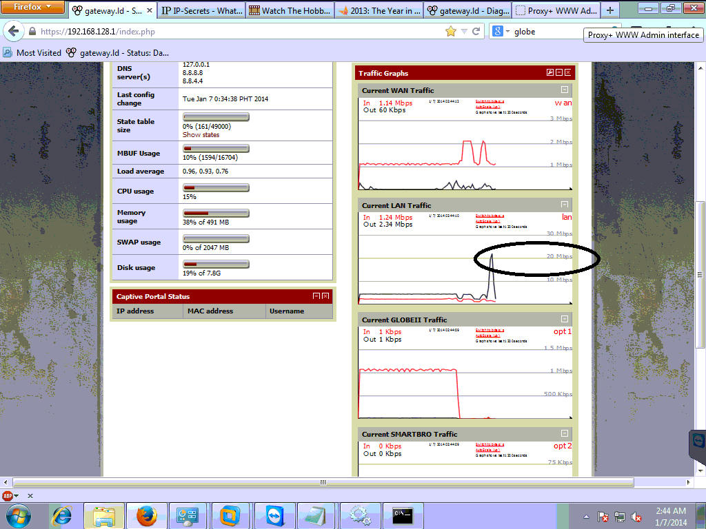

Have 3 wans two wans uses load balance for proxy. third wan is for gaming and other traffic. Using pfsense 2.1 upgraded from 2.0.3. Using Lusca Proxy.
