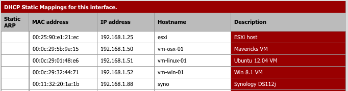

- I have some DHCP IP reservations for various hosts on my network, as here:
- I would like to be able to use the same DNS name/port to connect to these services when I'm on my local network and from outside. For example, I'd like a VNC connection to my.ddns.net:5900 to properly resolve and connect to 192.168.1.50:5900 regardless of where I am.
