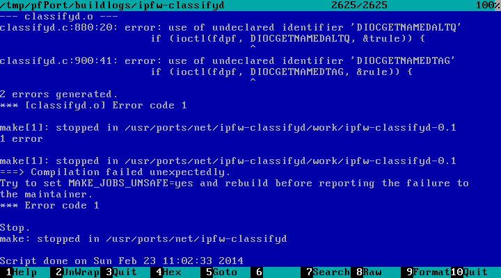

                              • _Adrian__ Offline
                                _Adrian_
                                Ugh… errors galore !!!
                                However...
                                Plan for failure
                                It is expected that the first try to build the ports, and the first try to build an ISO will fail, but subsequent attempts work. This is because certain parts expect files or binaries to be present that get built on the first run but not fully used until the second. This may get fixed eventually, but because the workaround is easy (just run the build again), it's not a priority.
                                I ran it again and still full of errors…
                                guessing thats due to V10 but i mainly think its because of this first initial error:
                                Operation ./build_pfPorts.sh has started at Sun Jan 26 12:26:30 MST
                                  –> Preparing for pfPorts build buildports.RELENG_2_1
                                  --> WARNING! We are about to run make includes.
                                  --> Press CTRL-C to abort this operation. . . . .
                                ==> Starting make includes operation. . .
                                make: "/usr/pfSensesrc/src/Makefile" line 178: warning : Couldn't read shell's output for "find /usr/pfSensesrc/src/sys/sys/param.h -mtime -0s"
                                make[2]: "/usr/pfSensesrc/src/Makefile" line 178: warning : Couldn't read shell's output for "find /usr/pfSensesrc/src/sys/sys/param.h -mtime -0s"
                                ==> Compiling pfPorts. . .
                                Executing Build ports.RELENG_2_1
                                Setting ports List : '/home/pfSense/tools/builder_scripts/../builder_scripts/conf/pfPorts/buildports.RELENG_2_1'
                                Setting MAKEJ_ports (-j) to ' '
                                Setting ports make.conf: '/tmp/pfPorts_make.conf'
                                After this everything is a catastrophe :/
                                Build [PACKAGE] (filename). . . Failed to build. Error log in /tmp/pfPorts/buildlogs/[PACKAGE]

                                • _Adrian__ Offline
                                  _Adrian_
                                  After a bit of messing around I got to menu.sh and found that there is an option that's not displayed on the wiki…
                                  RELENG_10_0
                                  Also edited and instead of merging with head I forced it to merge with 8.3
                                  I Will try again...
                                  Right now its at
                                  " Obtaining FreeBSD sources RELENG_10_0-supfile. . . "
                                  If it ain't broken, fix it till it is :P

                                    • _Adrian__ Offline
                                      _Adrian_
                                      No luck yet…
                                      Just chasing my tail here... I'm pretty close, but something is causing the build to fail.
                                      So will have to keep poking at it until I either figure it out or someone drops in with a few words of wisdom...
