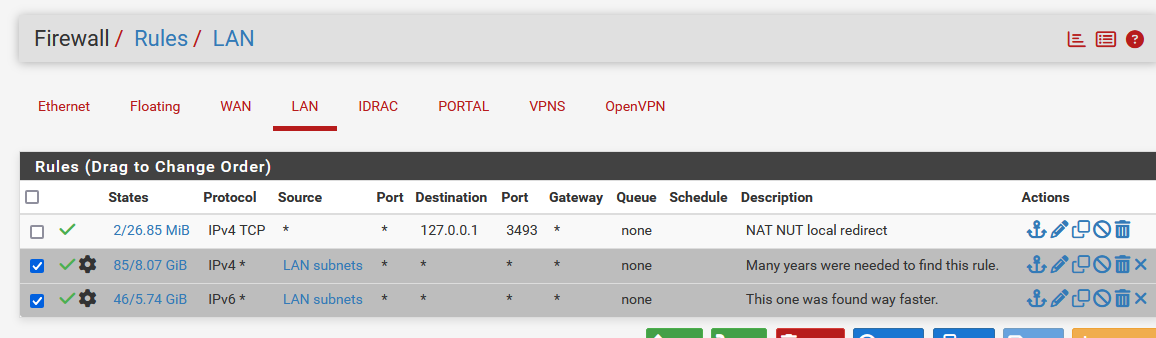

              I've solved the issue for myself with these selected two rules :
              and I found out later that these two rules are the ones present on the LAN interface when you install pfSense from scratch.
