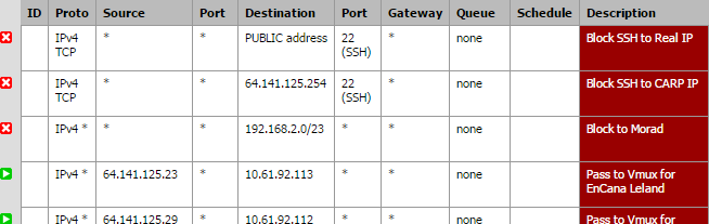

    My DMZ, or Public routed interface rules look like this now…
    • J
      so anherman - are you rules in place to block it then?  Cuz they are still open.  2 all 3 IPs.
      So you have a 1:1 nat setup or something?  Or your just routing the traffic?

        Yup, those rules are active.  No, no 1:1 set up at all.  I do have some inbound stuff set up, but specific ports like 21, 80, 443, etc.  Although I do have a couple that I have all ports forwarded to 3 customer devices, just because I don't know what ports they use - those are the ones noted in the middle of the WAN rules (noted as BCM access).  But those are other IPs.  Dumb question, how can I see what IP's they are trying to get authed on?  My pfflowd packages aren't  working, so I'm not sure how to look.

          Yeah it was towards the end of the day when I put that original rule in. I've since modified it to read as:
          block  IPv4 TCP * * WAN address 22 (SSH) * none
          I've corrected both the Floating and the WAN but I'm still telling you, SSH is open. The default deny isn't working in this case. Once that SSH server is enabled, it's WAN accessible on my box.
          My top 3 rules on the WAN tab (apologies on the formatting):
          block *            Reserved/not assigned by IANA * * *                         *        *   * Block bogon networks
          block *         Private_Networks                      * *      *                         *      none (custom rule)
          block IPv4 TCP *                                         * WAN address 22 (SSH) * none Block SSH remote access
          I don't have any 1:1 going either.

                    so you do understand its not just ssh that is open
                    pfsenseopentopublic.png_thumb
                    • J
                      If you PM a login - I would be happy to take a look to what is going on.
                      And ssh is still open..  If you flushed the states..  You go something major issue here..  Either your rules are not being applied or you have something that in front of it allowing it.

                          I don't even know where to start with what's wrong with your rules.  You might want to start over.
                          Of course everything is open.  You are connecting to something on PUBLIC net.  He has pass any any rules for that subnet from WAN1/WAN2.

                            Ok first thing I see is you have that allow any any rule on multiple interfaces..  So wan_shaw has any any to public net, and there is no blocks on that interface.  So when I do a trace to that IP I hit..
                            13    49 ms    49 ms    47 ms  66.163.70.2
                            14    55 ms    52 ms    64 ms  64.141.125.254
                            What what connection is that 66.163.. So you have that allow on all your interfaces?

                                Ok I put in a rule on your shaw wan to block ssh to your .250, 251, 254
                                And I it looks blocked now.
                                • J
                                  Ok I added logging to the rule, and you can see blocked from my attempt to all 3 of them
                                  Your going to want to go through these connections and block services to pfsense interfaces.  So for example I was able to remote in.. that should clearly be something you only allow when you want it.. And put in specific rule for ;)
                                  blockedinlogs.png_thumb
                                  • A
                                    acherman
                                    Okay, so I had rules just like to start with (see first post).  Weird.  So, which address were you able to get in on?
                                    • J
                                      I could ssh to all 3 of the ips.  And https is open on all three as well.
                                      Ssh is blocked now.. your going to want to block ports your gui is listening on.. https, I didn't check http.. And any thing else you might have running.. dns for example

                                      DUDE!!!! you have a recursive dns listening on the public net!!  That is normally not good!!  Bock that as well!!!

                                          This why you normally don't do a any any rule on your wan ;)
