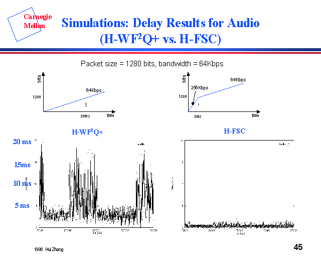

              Advanced real-time VOIP configuration
              Say you want to efficiently improve your VOIP setup. You have 7 VOIP lines and a 5Mbit upload. Each VOIP packet is 160 bytes (G.711), with an average bitrate of 64Kbit/s per line (a 160byte packet sent every 20ms). We want to improve our worst-case delay (which also improves worst-case jitter and overall call quality) from 20ms to 5ms, so we calculate the bitrate needed to achieve that:
              160 bytes × 8 = 1280 bits
              1280 bits × (1000ms ÷ 5ms) = 256000 bits/s
              So, to send a 160 byte packet within 5ms we need to allocate 256Kbit/s. This gives us our m1 (256Kb) and our d (5).
              Now we need to calculate our maximum average bitrate:
              7 lines × 64Kbit/s = 448Kbit/s
              Just to be safe, we allocate bandwidth for an extra line, so
              8 lines × 64Kbit/s = 512Kbit/s
              This gives us our m2 (512Kb).
              To make sure that your m1 (the per packet delay) can always be fulfilled by your connection, make sure that the m1 (256Kb) multiplied by the maximum number of simultaneous sessions (7 or 8) is less than your maximum upload. 2048Kbit (256Kb × 8) is less than 5000Kbit, good.
              Our finalized configuration is:
              m1=256Kb
              d=5
              m2=512Kb
              This configuration will guarantee a 7.4ms (5ms+MTU transmission delay) worst-case delay for each packet, with a limit of 8 simultaneous calls (512Kbit/s). We get low-delay, low-jitter calls as though you had allocated 2048Kbit/s of bandwidth, but you actually only allocated 512Kbit/s of bandwidth.

                I think it's simpler to just use the single packet case. If you have 1 160byte(1280bit) packet every 50ms, that's 64kbit/s. But, at 64Kb/s, HFSC is allowed to schedule that packet in any manner, as long as it completes before the 50ms to send the next packet. This means your absolutely worst case is 50ms.
                If you want this packet to be sent out faster, say 5ms, then you need "5ms" of bandwidth for scheduling reasons. That will take 256Kb of bandwidth to send 1280bit packet in 5ms. But you don't need 256Kb average, just 256Kb of burst. So you tell HFSC, 64Kb average, 256Kb burst for 5ms.
                Or something along these lines.

                          (Using the scenerio from earlier.)
                          If 8 packets are instantly queued and m1/d was per queue, the queue would only get 256Kbit for 5ms which would only be 1 packet transmitted, violating the HFSC's latency guarantees for the other 7 packets.
                          If it were per queue we'd need to set m1 to 8x the bandwidth to support 8 concurrent sessions, which may be true, but I think m1/d is per packet since HFSC's m1/d/m2 correspond with the umax/dmax/r, which is defined in page 10 the HFSC paper as follows:
                          Each session is characterized by three parameters: the largest unit of work, denoted umax, for which the session requires delay guarantee, the guaranteed delay dmax, and the session's average rate r. As an example, if a session requires per packet delay guarantee, then umax represents the maximum size of a packet. Similarly, a video or an audio session can require per frame delay guarantee, by setting umax to the maximum size of a frame.
                          umax = packet and umax/dmax directly correspond with m1/d, therefore m1/d are per packet as well.
                          Edit: Also, I'm not sure what "session" means exactly… maybe flow?
                          I don't understand the HFSC paper very well, but the few parts I do understand only mention single session (flow?) queues, which may be the only way to to properly use HFSC, but that seems strangely limited.
                          We'd had this per packet/queue argument before and I had few more references, but I forget them now. Maybe they're in this thread? Reading the source-code or even the pseudo-code found in the HFSC paper could answer our question, but it seems too advanced for me...
                          Testing this per queue/per packet theory should be reasonably easy. Someday...  :-\

                            @Nullity:
                            Latency guarantees are only guaranteed if you don't go past your bandwidth limit. If you burst 8 1280bit(160byte) packets at once, the last packet is going to have 8960bits of data in front of it and 10,240 including itself. To send 10240 bits in 5ms, you need 2mbits of bandwidth. You can't have your cake and eat it to. It is impossible in this universe to guarantee all 8 packets will get sent within 5ms with anything less than ~2Mb/s.
                            Even in this case, the average bandwidth is 1280bits * 20/sec(every 50ms) * 8 packets = 204,800bps, which is about 1/10th the bandwidth you need to make sure none of those 8 packets hang in the queue for more than 5ms. You need about 2Mb/s, but you only need it for 5ms. Your average is 204.8Kb/s.
                            m1 = burst
                            d = duration of burst (of course you can't send fraction packets, so you need to make sure all the packets you want to burst fit m1*d)
                            m2 = overall average
                            m1 is moot if you attempt to go over m2.
                            *my interpreation

                                Any response to the HFSC paper saying that m1/d & umax/dmax are per packet?
                                It's confusing since m2 is obviously per queue.
                                Well, actually, it doesn't exactly say it's per-packet. It just says "if a session requires per packet delay guarantee, then umax represents the maximum size of a packet"… so, would 7 separate VOIP flows be considered a single session or multiple sessions? Is a queue's traffic considered a single "session", regardless?
                                Fuck, I really don't want to read the HFSC paper for the 100th time... Though, IIRC, the paper only mentions single-flow scenerios, so the source-code might provide the only proper answer.
                                I'm beginning to think you may be right though; m1 should be multiplied × 7 to support 7 concurrent flows.
                                HFSC... :-\

                                      Packets aren't evenly distributed, so the problem attempting to be solved is to reduce latency caused by this uneven distribution. Some of the uneven distribution is caused by bursts of packets, but other parts is because packets are atomic and of the packet is too large for the available bandwidth (this is the case they focus on when describing the problem), your latency may go up. You can hide this latency without increasing the average bandwidth by "bursting" the bandwidth and making it unevenly distributed.
                                      Of course this happens by temporarily increasing the bandwidth at the micro-level, but not the macro-level.
                                      This is what I think they're trying to solve with m1+d.
                                      edit:
                                      Another way to say it is bandwidth and latency are naturally coupled. For example, you cannot send a 1500 byte packet on 1Mb/s link in less time than 12ms (assuming store-and-forward). For any given bandwidth, there is a minimum latency for a given packet size.
                                      HFSC allows you to "decouple" latency and bandwidth by temporarily giving a queue more bandwidth to make it act like it has the latency of higher bandwidth, but at the same time, you don't want it to have more than its fair-share of bandwidth.
                                      HFSC also has a secondary decoupling of bandwidth and latency, but it's not that it's trying to decouple the natural coupling of bandwidth and latency, but the pseudo-coupling of bandwidth and latency that nearly all traffic shaping algorithms seem to have. This coupling isn't a fundamental natural coupling, but a biased characteristic that most algorithms have. For example. Many times giving one queue 2x more bandwidth than another queue will result in that queue having 1/2 the latency, even when the link is idle and you attempt to send a single small packet. This is because most algorithms use a kind of "back-off" strict priory based scheduling. This causes the shaper to "wait" for free bandwidth, and the less bandwidth a queue has, the longer it wait before it decides "yes, this bandwidth really is free".
                                      HFSC uses "curves" to dynamically change the priority of a queue. If a queue is idle, it will have the highest priority. This means a 64kbit/s queue can have a higher priority than a 1Gb/s queue. But as soon as a packet goes through that 64kb queue, suddenly its priority drops. How far it drops relative to other queues is dependent on the relations of their assigned bandwidth. In this way, HFSC can pretty much guarantee that a queue of a given bandwidth should never have a latency worse than that of dedicated link with that same amount of bandwidth(ignoring kernel scheduling issues). But a queue can have a latency as low as the actual physical link rate.
                                      The typical observed latency is probably some where between. In most real networks, the vast majority of connections are TCP that respond to congestion and a connection is rarely capable of actually maintaining 100% saturation for more than a short burst. What this many times means is there is a bit of breathing room on the link. This causes your typical observed latency to be quite low, closer to the link rate than the provisioned rate, unless you queue is bufferbloated with a large backlog.
