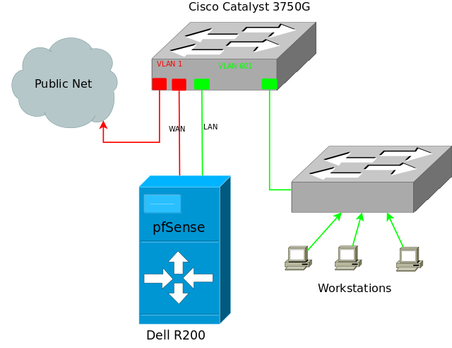

  • OK, here's my network diagram (I never said I had artistic talent…)
    The switches are set up so that VLAN 1 is the "outside" VLAN.  My workstations are all on VLAN 601.  The WAN interface is behaving itself fine without setting up VLANs in pfSense.  Is it OK to leave it alone?
    The LAN interface is hooked up to a port that is on VLAN 601.  All my lab machines are also hooked up to 601.
    I tried setting up a VLAN on the LAN interface, but I then lost contact with the pfSense machine. I had to reset it at the console in order to get it talking to the LAN machines again.
  • Actually, this diagram might be a little better.  The previous diagram is close the the logical layout, but this one captures the physical layout better.
    The switches for the lab machines are in the same room as the uplink to the outside, the pfSense box is in the server room on the server room switch, and both the WAN and LAN VLANs are carried over a trunk between them.
  • The switches are set up so that VLAN 1 is the "outside" VLAN.  My workstations are all on VLAN 601.  The WAN interface is behaving itself fine without setting up VLANs in pfSense.  Is it OK to leave it alone?
    As you don't need any routing between vlans it should work. The switch port's connected to pfSense and workstations just needs to be untagged.
    Also make sure that vlan 601 is a member of the Trunk.
