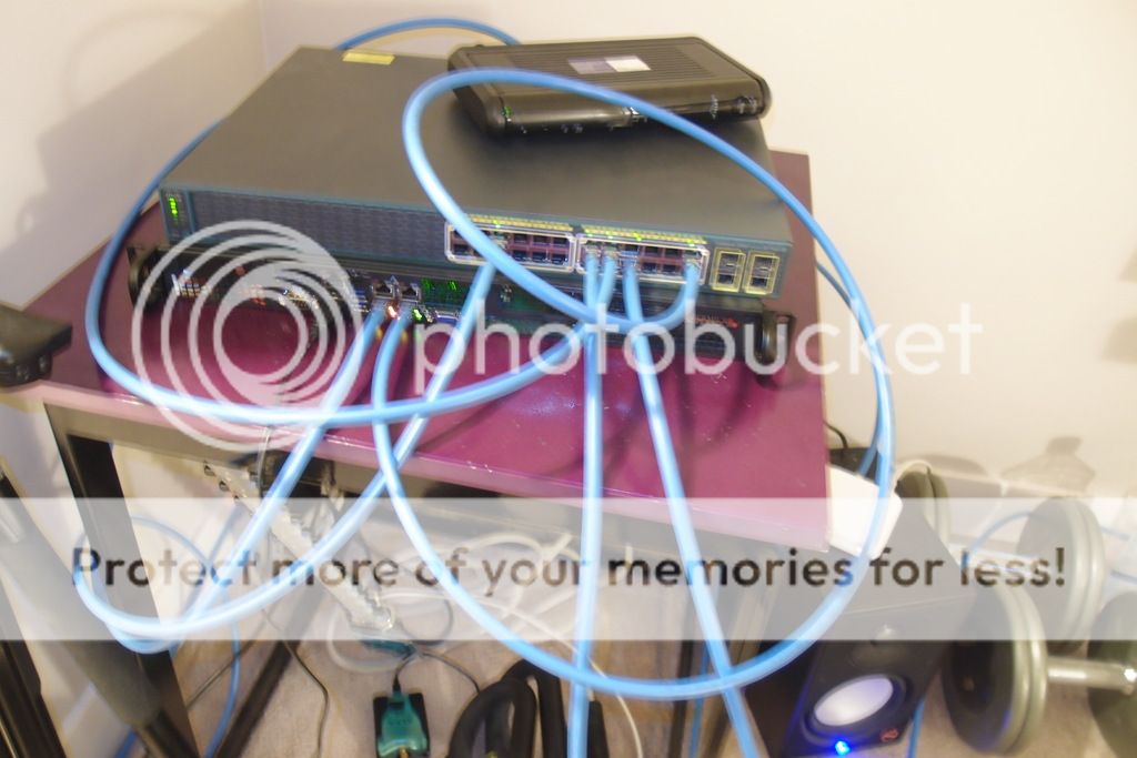

I recently purchased a used 10/100 Cisco catalyst switch and figured it was time to upgrade to cat 6a from my old cat 5e cables.
I decided to make my own cables and bought a spool of this superior essex 6A CMP cable.
This upgrade made no difference at all and these cables aren't flexible at all!!!
https://www.anixter.com/en_us/products/6A-272-2B/SUPERIOR-ESSEX/Voice-and-Data-Cable/p/CMP-00424SUP-10G-06Hopefully someone doesn't make the same mistake I did.

cat6a = 10gbit @+-90metersyou say you run a 10/100 switch … makes no difference with those speeds.
and no, those cables are not flexible at all, because you didn't buy patch-wire ; you bought installation wire that should be terminated on a keystone/wallsocket/....

Wow!!! thank you so much! I was unaware of there being solid or stranded wire option! My cable lengths are nowhere near that! My longest is 50ft.
There is no reason to use anything above Cat5e for 10/100 or even gig-e.
stranded wire is more expensive and has higher attenuation then solid wire. stranded wire should be used between wallsocket<->device & patch-panel<->switch.
