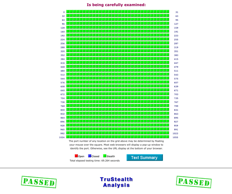

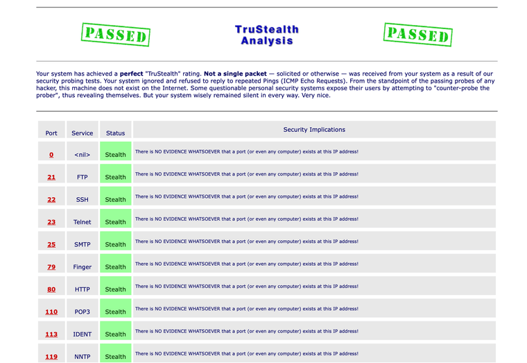

If you try the ShieldsUP site (www.grc.com), what does it tell you? This sounds like a 'herring-rouge' to me if you're getting conflicting reports from different sources.
Your system has achieved a perfect "TruStealth" rating. Not a single packet — solicited or otherwise — was received from your system as a result of our security probing tests.
There you are then!
Alright sir, I won't worry about it then. Thanks for the help everyone.
