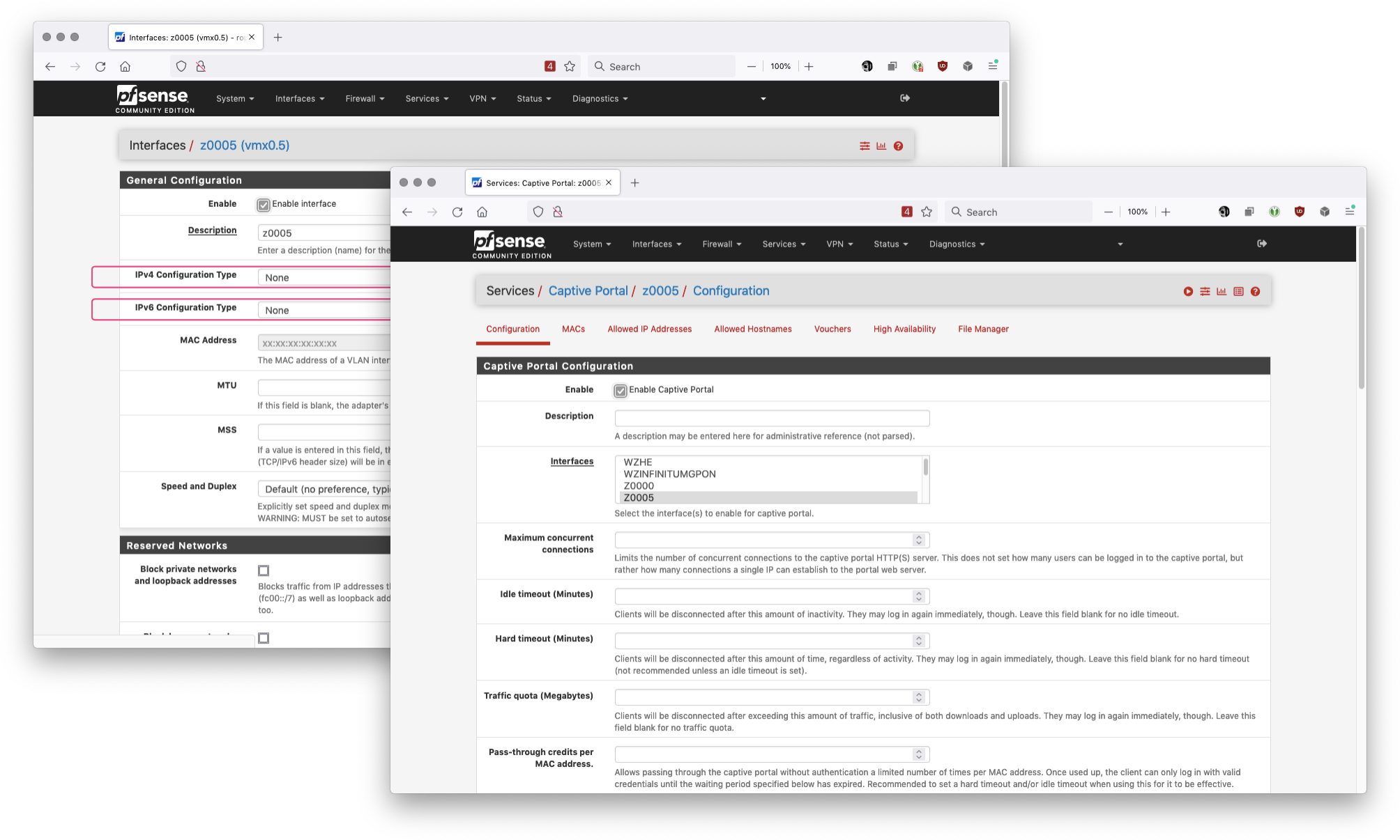

  • Do portals work on bridged segments?
    672 Views
    GertjanG
    @skilledinept A 'captive portal' needs a IPv4 IP and network - and a running DHCP server for that interface. Unbound needs to listen on that interface. Because you use VLAN : the device at the other end of the 'LAN' cable (over which the VLAN "5" is running) need to handle VLAn's and set up to sift out this VLAN5. That could be your AP's), or, by default, a VLAN capable smart switch.
