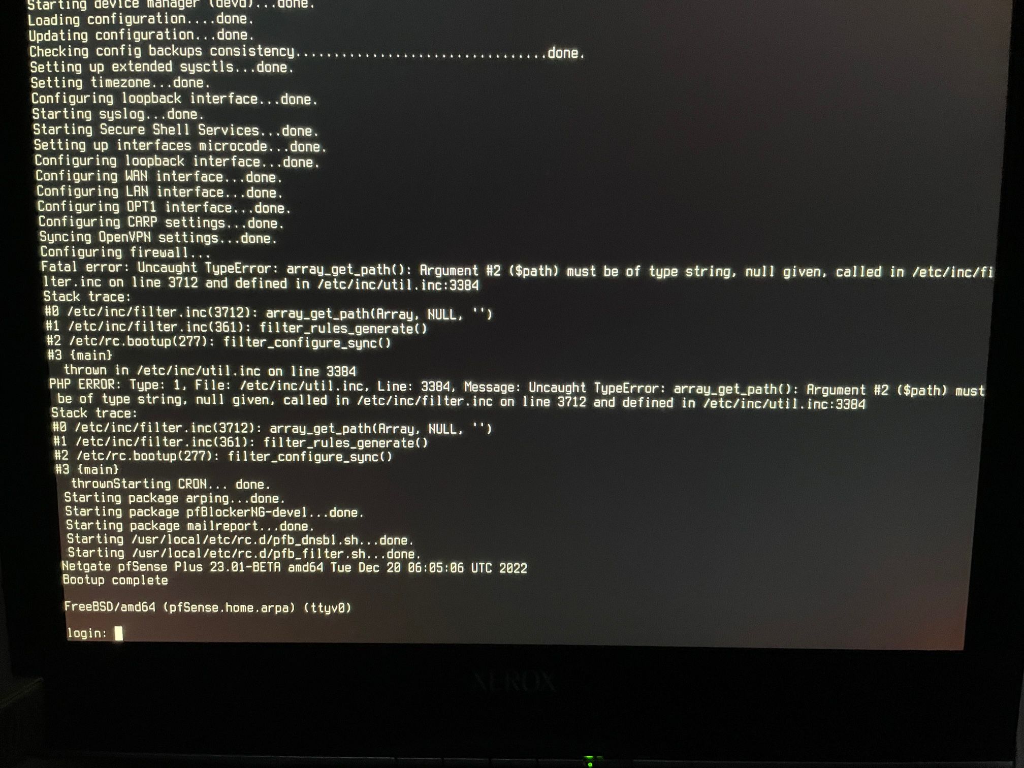

  • PHP error /etc/filter.inc 3712 & /etc/inc/util.inc 3384
    2 Votes
    593 Views
    @jimp Issue resolved, back in business. Ted Quade

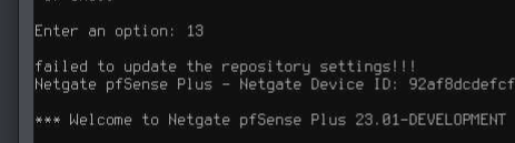

  • Failed to update repository settings
    If you are running an older snapshot and seeing that error: failed to update the repository settings!!! Then do this to pull in the fixes for it: pkg upgrade -fy pfSense-upgrade pfSense-base Then upgrade from the command line to reach the current snapshot: pfSense-upgrade -dy Steve
