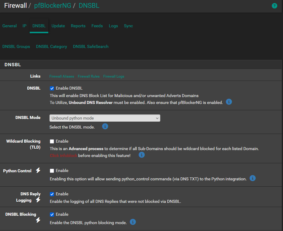

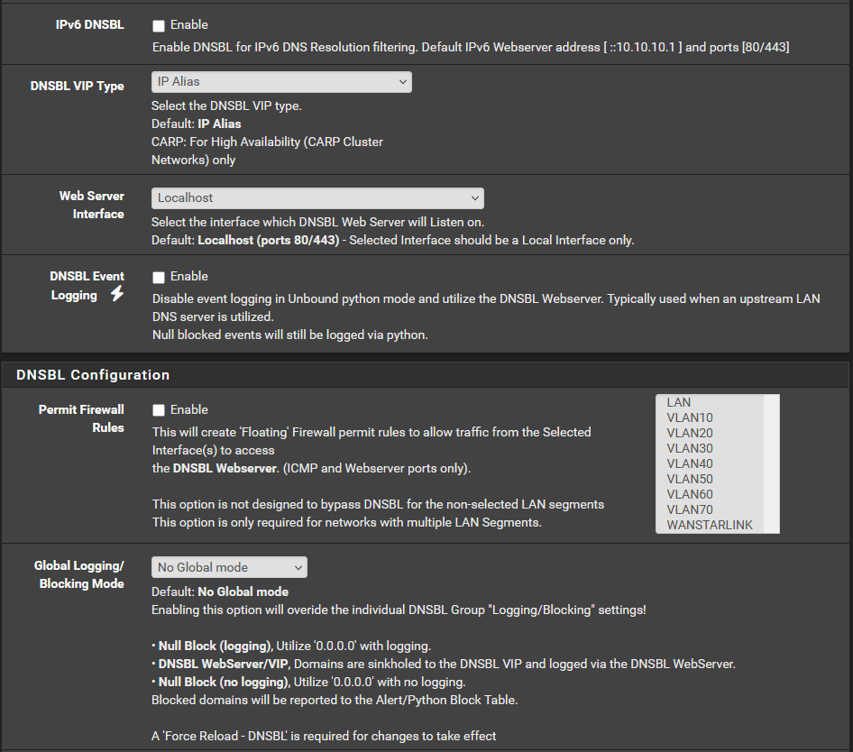

      2 of 4 ok) I have successfully changed Firewall > pfBlockerNG > DNSBL > DNSBL > Logging/Blocking Mode to "Null Blocking (no logging)" and there's no internet problem. But there was no choice for "Null Block (logging)", not sure if this is because I did not set "DNSBL Mode" to "Unbound python mode" <-this is the next item 3 below
      3 of 4 problem) When I set Firewall > pfBlockerNG > DNSBL > DNSBL Mode to "Unbound python mode" we lose internet connection so I returned it to "Unbound mode". This was also what happened when I tried this last month. Are there other settings that I need to change from this:
      4 of 4 question) Do I understand correctly that because we have 2 WANS and the pfsense instruction is to ensure each WAN has a DNS entry in System > General Setup > DNS Server Settings, then I should enable Services > DNS Resolver > General Settings > "DNS Query Forwarding"?

        @richardsago said in How to block internet access for client operating system's DNS over HTTPS:
        "Null Block (logging)" works only when Python mode is enabled.
        That's not a normal situation at all. You have a DNS issue then.
        Consider flipping everything back to default first.
        This is part of 'default' :
        In a nearby future, 'unbound' mode might as well be removed.
        You can see "python mode" as a plugin or addon to unbound.
        It's a script file that unbound uses
        Unbound uses 'python' as the interpreted script file language , and that's why we call it 'python mode'.
        It could have been a shell script, LUA, or whatever.
        This Unbound Python script has now been tested a couple of multiples of trillions times (every DNS request executed by every pfSense using pfBlockerng out there).
        It's a save bet that to say that there are no more known issues with it.

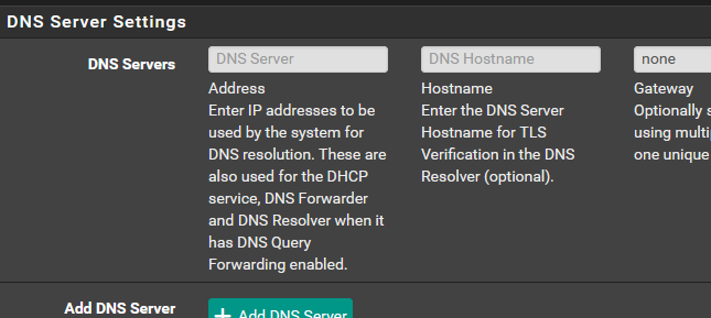

        About :
        You might as well remove all these.
        pfSense, the resolver, doesn't need any DNS servers (that you've assigned).
        It doesn't use them.
        Unbound is a resolver, which means it resolves using the official (root) DNS servers.
        No need to use some commercial offer from anybody.
        8.8.8.8 and 8.8.4.4 are also revolvers btw. But why would you hand over your private DNS requests to these commercial entities ^? ^

          Thank you @Gertjan for the reply and sorry for this late reply. If I will remove the DNS Servers on System > General Setup > "DNS Server Settings", do I need to enable Services > DNS Resolver > General Settings > "DNS Query Forwarding"?
            johnpoz LAYER 8 Global Moderator @richardsago
            @richardsago out of the box pfsense resolves, there is no need for setting anything to be honest. It works out of the box.
            If you have been messing with settings in the resolver - forwarding would be not enabled. And the only thing pfsense would point to is its loopback for dns would be 127.0.0.1 and the ipv6 version of that "::1"

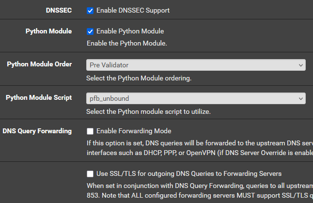

                • Set Services > DNS Resolver > General Settings > "Python Module" to enabled
                • Return Services > DNS Resolver > General Settings > "DNS Query Forwarding" back to default of disabled
                • Removed all DNS Servers in System > General Setup > DNS Server Settings
                DNS Resolver enable Python Module
                Remove DNS Servers
                Dashboard now says only 127.0.0.1 and ::1 as DNS servers

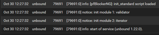

                But when I set Firewall > pfBlockerNG > DNSBL > DNSBL Mode to "Unbound python mode" the web browsing is not successful but viber messaging is still working. Can you please check if there are other DNSBL settings that I have to change? I have reverted to Unbound for now but this was the screenshot when it was at unbound python mode and finished pfBlockerNG Reload DNSBL and firewall restart:
                This is the last four lines from Status > System > DNS Resolver:
                I think my pfBlockerNG setting is the cause and not firewall rules because things were working it was on Unbound and only stopped working in "Unbound python mode"

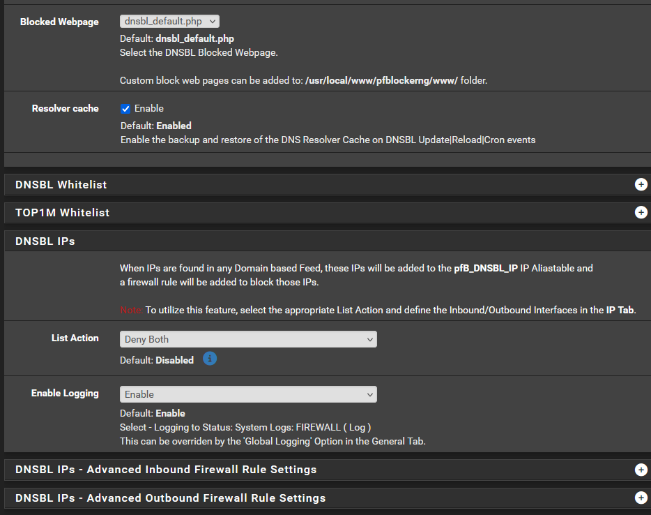

                  Not a solution, but a couple things that may help. The free DNSBL list in PF blocker are only updated once a month at the most. I would go back through and change all of your update settings to weekly. An example is is the UT1 list that you have enabled. A quick check told me the last time that list was updated was eight months ago. Personally, I would not run that list yet. It’s a big list and if you don’t have the CPU horsepower or RAM it’s just going to bog your system down. Plus trying to block porn is like trying to control the weather. I would start with your Steven black list, get things running how you want. Then add just one list at a time and see how the system handles it.
                  I would also disable DNSBL IP, put it back to stock settings. I dont understand what function it preforms exactly. Im just thinking it could be one of the sources of your problems.
