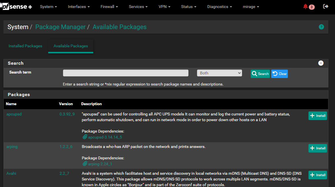

                                      Hi I have the same issue
                                        What do you see from: pfSense-upgrade -dc
                                        • K Offline
                                          Kelpie @stephenw10
                                          >>> Updating repositories metadata...
                                          Fetching meta.conf:
                                          Fetching data.pkg:
                                          Fetching meta.conf:
                                          Fetching data.pkg:
                                          Your system is up to date
                                            OK that seems fine. You might try: pkg-static -d update
                                            But I would expect pfSense-upgrade to throw an error if that does.
