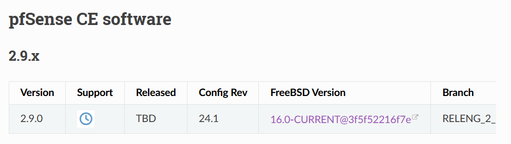

            I'm running CE version 2.8.1 and just got one of these messages. Here are some observations:
            Here's the message:
            "check_upgrade: "Updating repositories metadata" returned error code 1 @ 2025-11-21 02:17:59"
            When I go to this page...
            https://docs.netgate.com/pfsense/en/latest/releases/versions.html#id5
            ...I see this:

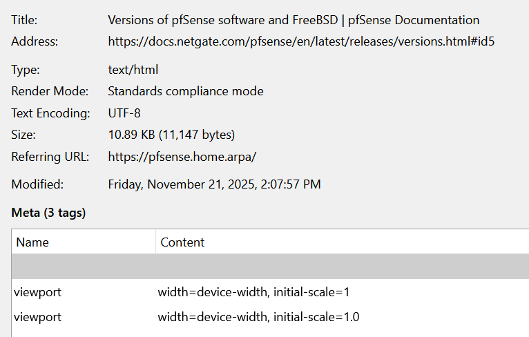

            When I check "page info" on my browser, I see this:
            Note the timestamps.

              @Spacecase said in check_upgrade: "Updating repositories metadata" returned error code 1:
              So? An update to the release notes documentation page doesn't mean anything. Also others have other timestamps as they were checking their systems at other times.
              In addition I have the same problem running plus where the 25.11 docs page is up for days/weeks. Nothing to see there.

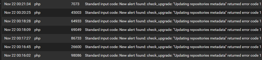

                        @stephenw10 said in check_upgrade: "Updating repositories metadata" returned error code 1:
                        It checks for available upgrades every 24hrs or whenever you open the dashboard if you have the system info widget on there.
                        But it will try to update the pkg db any time you do a pkg operation.
                        The error got triggered way more then that. I have logs where it essentially spammed the syslog while noone was logged in so no dashboard etc.
                        Also on another note: the "failed" PKG that is now a way higher version and can't be run essentially blocks the LLDPD package from running as it throws the same elf-ld.so errors around. So if someone could please fix that new pkg package being pushed downwards to 25.07 when NOT trying to update, that would be great, as it essentially fucks up a few packets that won't work anymore :/
                        I have to manually run pkg-static install -f pkg and forcefully downgrade it to 1.21.3_5 again so my services come up again.

                        edit: just as an example from yesterday night's log just before the rotation. logged in around 11:30pm so waaay later then the logs show. So that error - when it happenes - is not only triggered every 24h or when pkg ops run - something triggers it often and hard.
                        Nov 21 23:59:56	php	10056	Standard input code: New alert found: check_upgrade: "Updating repositories metadata" returned error code 1

                          stephenw10 Netgate Administrator @JeGr
                          @JeGr said in check_upgrade: "Updating repositories metadata" returned error code 1:
                          Hmm, that's unexpected. pkg is the only think that would ever update itself. The non-static version then fails because the libs are not updated.
                          Do you have the output error shown by lldpd?
                          • K Offline
                            Kelpie
                            Hi I have the same issue
                              What do you see from: pfSense-upgrade -dc
                              • K Offline
                                Kelpie @stephenw10
                                >>> Updating repositories metadata...
                                Fetching meta.conf:
                                Fetching data.pkg:
                                Fetching meta.conf:
                                Fetching data.pkg:
                                Your system is up to date
                                  OK that seems fine. You might try: pkg-static -d update
                                  But I would expect pfSense-upgrade to throw an error if that does.
