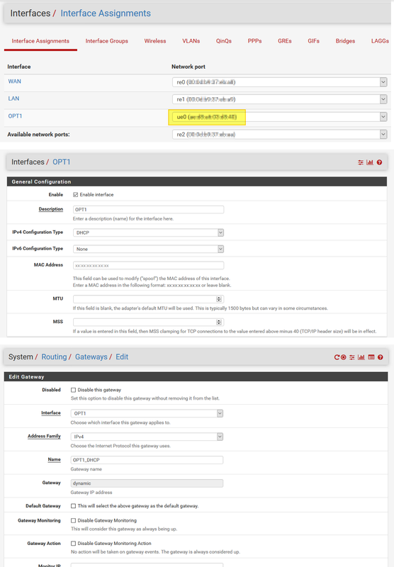

                    discofris
                    Connected via USB, it appeared as an extra interface, found this in my notes:
                    notes

                                Just wanted to add that due to another emergency, I found myself trying to connect my TP-Link M7350 to my SG-3100 again, and I had success in two ways...
                                Firstly, I connected the WAN port of my SG-3100 to a Win 11 laptop and connected the M7350 to it's USB port. Win 11 just found it and set it up like any other network interface, which means you can then go in to the connection properties and select the Sharing option to share it. The SG-3100 can then route through it just fine... The downside is the laptop having to be on and taking up space.
                                So I then tried connecting the M7350 direct to the USB port and sure enough the Interfaces menu in pfSense showed a new port for UE0 which I was able to map to a new DHCP interface. And it all just worked! So I don't really understand what all the talk above about taking bits of kernels apart is about, but I can confirm this device does just work.
