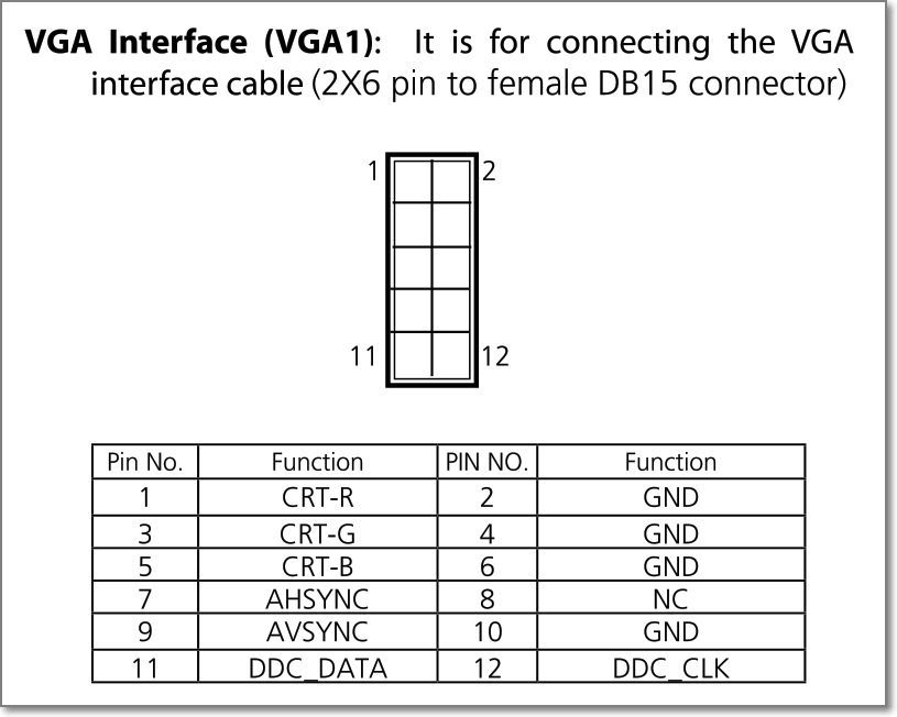

                          jriofrio @zanthos
                          @zanthos Hello Sir,... I'm a little puzzle here in how I should connect the db15 to the 12 pin header on the motherboard of the M400.
                          Could you match/link the pins of the DB15 to the 12 pin header. Pin by pin. Please.
                          I really appreciate your help on this.
                          Thank you for your help... Good day

                              jriofrio @stephenw10
                              @stephenw10 I am trying to make the cable myself. This is just in case somehow I need it in preparation for installing pfsense in a M400 box.
                              I prefer to have options before the attempt rather than scrambling to get the info in case of the need, at the same time is good to have the knowledge for my need or someone else that might need it to.
                              By the way in order to have keyboard and mouse, do you use the USB ports on the M400 box or some other way?
                              Thank you again for any info you could provide.
                              Good day
                                  @stephenw10 I probably will be updating the BIOS of the m400 too.
                                  Hope is not too much trouble to share the cable info..... Thanks

                                    I don't use the VGA output on that box so I can't help you there. ๐Ÿ˜‰
                                    But IIRC the output is pretty standard across most Lanner boxes.
                                      jriofrio
                                      Well, I thank you for your time.....
                                      Does anyone in this chat have information about the pins connection of the VGA 15 pin to the 12 pin VGA header on the M400 motherboard?
                                      If a diagram can be provided will be best.
                                      Also does anyone knows if the USB ports of the M400 box can be used for keyboard and mouse input?..... If not, is there a header in the motherboard that can be used for keyboard and mouse input.
                                      Appreciate any info anyone could provide.
                                      My thanks to all... Good day
                                        Mookatroid @jriofrio
                                        @jriofrio
                                        Directions are rather generic as there will be variances when it comes to the colour coding for each wire in a VGA DB15 connector.
                                        In short ......
                                        .... VGA header pins, 1, 2, 3, 5, 7, 9 on the M400 PCB ..... need to be connected to ......... Red, Green, Blue, Hsync, Vsync and Ground, on the DB15 VGA connector.
                                        I had to use my meter to determine which VGA wires were the required wires before I could connect it all.
