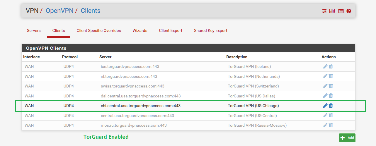

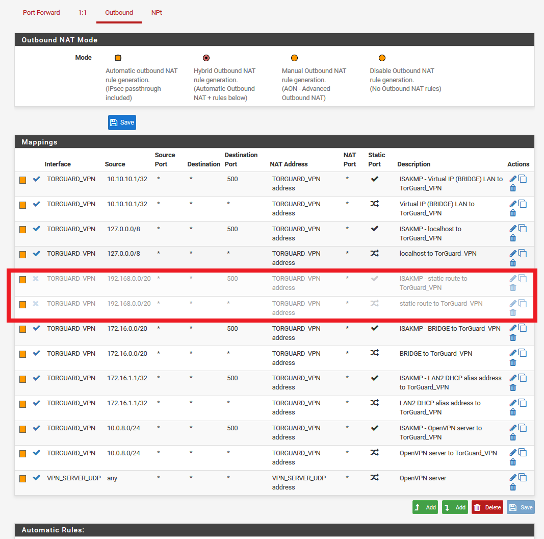

      I have a rule on my lan_bridge to send all traffic to the TorGuard gateway ...when Torguard is VPN client is enabled, all traffic routes through the VPN service and when the VPN service has been disabled traffic routes directly to the WAN as expected...
      The only other thing I configured for the VPN service was the NAT rules as defined in the guide I posted above
      If that's not what you mean, please explain

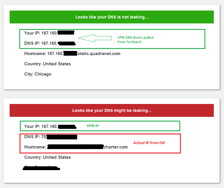

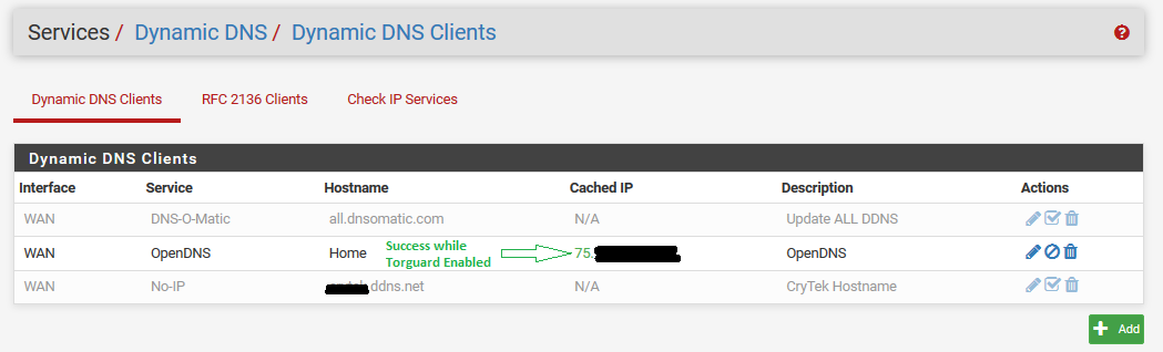

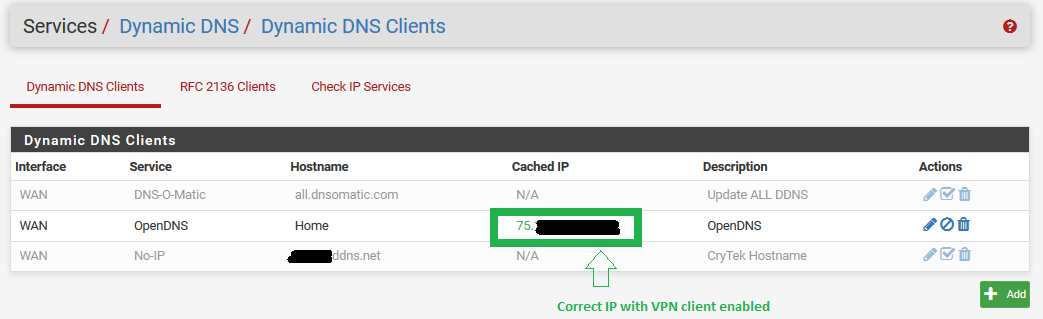

            • T Offline
              teknikalcrysis

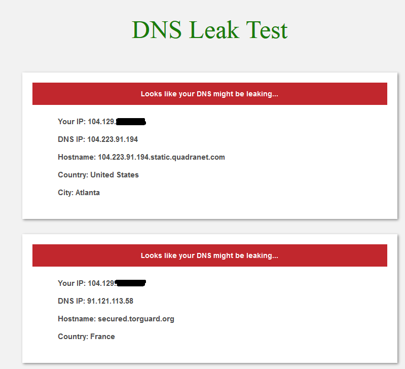

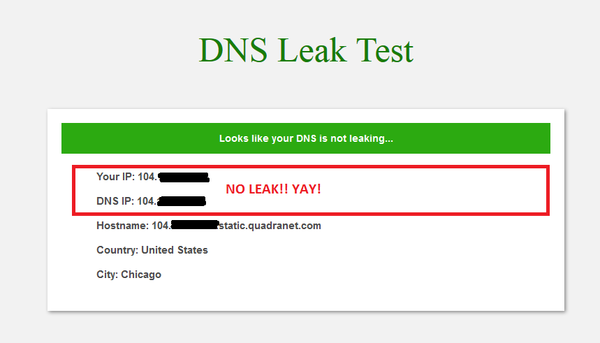

              Okay, I have CHECKED that option
              However, after Checking that box, I now have a DNS leak
              If I leave the box UNCHECKED, this is the DNS test result
              2.4.3-RELEASE-p1 (amd64) - FreeBSD 11.1-RELEASE-p10
              AMD G-T40E Processor - 2 CPUs: 1 package(s) x 2 core(s)

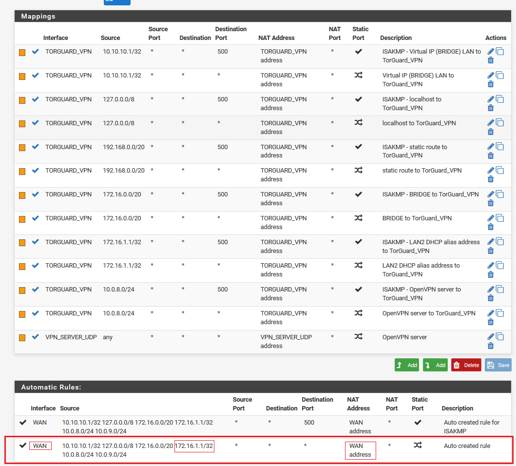

                Here are some related settings
                LAN Rules related to TorGuard

                  • DerelictD Offline
                    Derelict LAYER 8 Netgate
                    Set your VPN clients to use outside DNS servers instead of the DNS resolver on the local firewall.

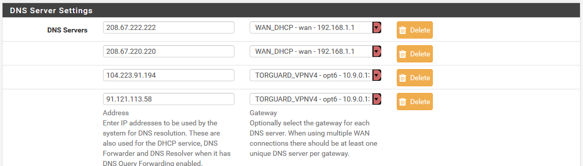

                      @derelict You'll have to excuse my ignorance LBVS
                      How do I do that?
                      I thought I was accomplishing that in the General System Settings by providing a DNS server tagged to the TorGuard VPN gateway

                      • DerelictD Offline
                        Nope. Set them in the DHCP server most likely, else static on the hosts.
                        The DHCP server will automatically give hosts the interface address if DNS servers are not specified.

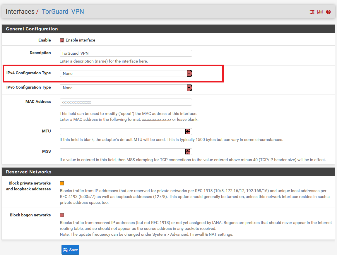

                        • T Offline
                          teknikalcrysis
                          So your saying I should setup the TorGuard Interface as DHCP? as I have it set to none at the moment and it just sets a Virtual IP

                          • DerelictD Offline
                            No. It's about what the CLIENTS that are routed over TorGuard are, themselves, configured to use as DNS servers. The DHCP configuration would be on that interface. If you only want to change certain hosts, use DHCP static mappings.

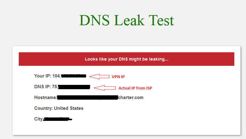

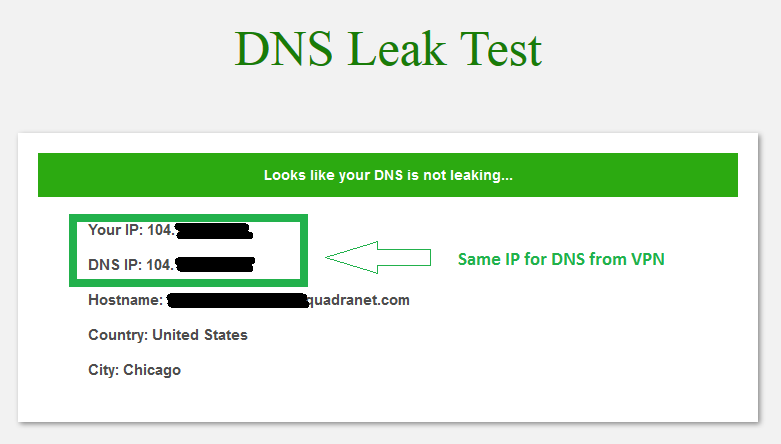

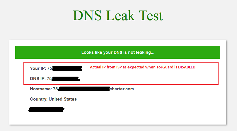

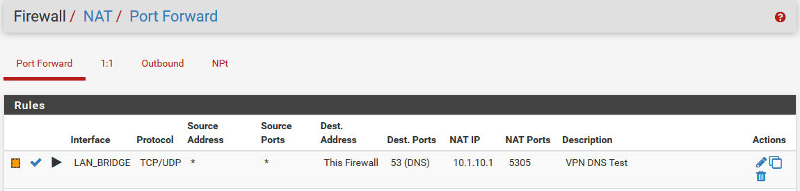

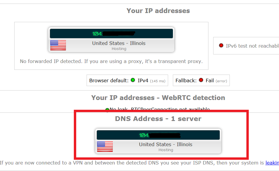

                                            I have been trying a bit of everything...I was leaning on hope that there would be a way to create a rule somewhere that would route the dyndns traffic to a specific gateway like I have made with having my PC pushed trough the TorGuard VPN and simultaneously default traffic from the kids' tablets to bypass the TorGuard gateway and use the WAN directly...
                                            While having the "Do Not Pull Routes" option checked in the TorGuard VPN config, I tried to make use of both the DNS Forwarder (dnsmasq) and DNS Resolver (Unbound) at the same time by creating a Virtual IP of 10.1.10.1 having Unbound listen on port 53 and dnsmasq listen on 5305 and then NAT Port-forward traffic DNS to the Virtual IP
                                            While this does make a change is the right direction by making use of the DNS server listed in General Setup
                                            RESULT: 0_1528862315153_result.png
                                            It tries to force all traffic to the DNS Forwarder (dnsmasq) even when the TorGuard VPN has been disabled/disconnected and it bypass the DNS Resolver (Unbound) all together
                                            And then thing I dont like about using (dnsmasq) is that the DNSBL in pfBlockerNG is then circumvented is it not?
                                            I DID try to use the static DNS setting in the DHCP mapping as suggested, but it forces the PC to consistently use those specified DNS servers even when TorGuard has been disconnected, and again by having DHCP specify those servers, isn't DNSBL in pfBlockerNG getting bypassed at that point?
