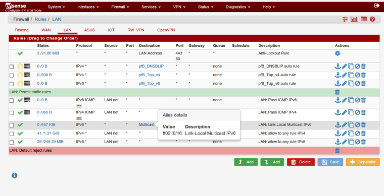

                                        • IsaacFLI Offline
                                          IsaacFL @JKnott
                                          @jknott said in In a firewall rule, what is included in "LAN net" for IPv6?:
                                          I just tried adding that rule and capturing the traffic as the test computer boots up. Wireshark shows the same as before, but Packet Capture now shows 14 packets captured, but none of them are DAD. Something strange is going on here. Packet Capture is running on the pfSense firewall and Wireshark on a computer connected via a managed switch, configured to mirror the traffic.
                                          What I use for testing, is a "pass" rule, IPv6 "any" to "ff02::0/16"
                                          Then if you use Wireshark, you will see pfsense participating more on the link.
                                          When you disable the rule, not so much pfsense. Also, a lot of the traffic gets repeated, trying to find the router.
